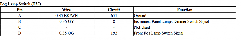

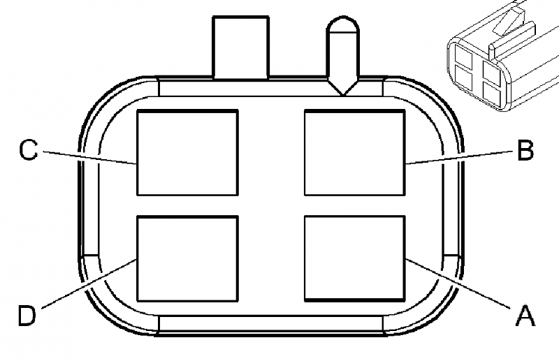

I'm installing fog lights as well on a 08 Chevy HHR LT1, I took off the water fall the previous owner cut the harness off, so all I have are the color wires. Can anyone tell what each color connect to. Orange wire, sold Gray and black/w gray strip. I like to be safe than sorry. Thanks

Like this?
I moved your post to a new thread.
Attached Thumbnails fog switch wiring-fogconn.png   fog switch wiring-fogpin.png
