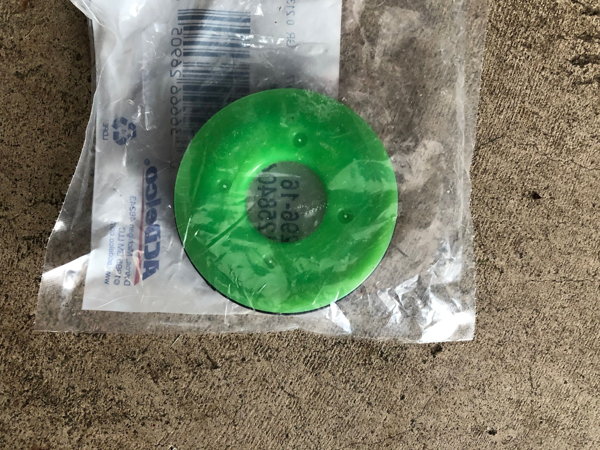

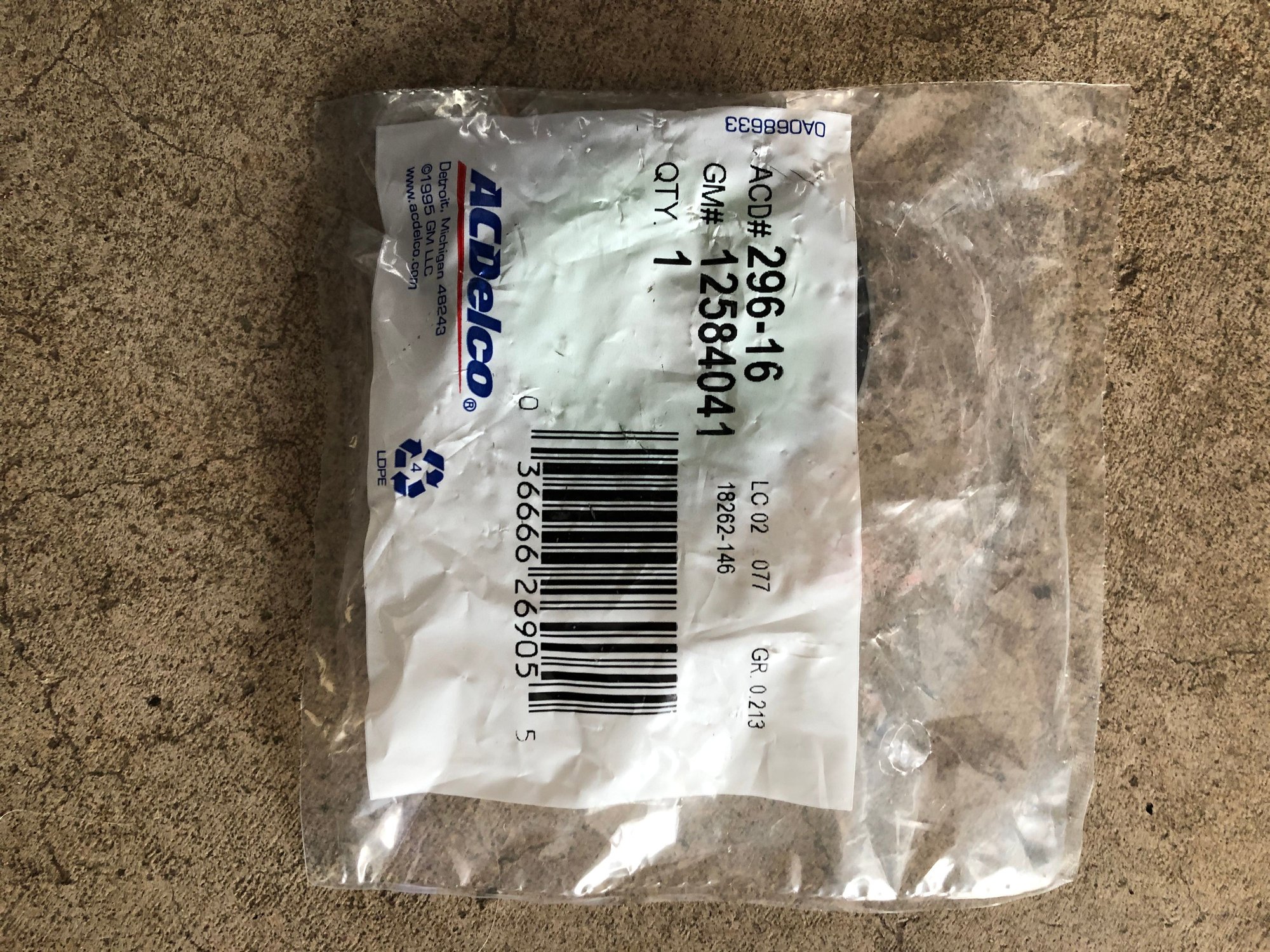

This bolt, seal and plumbing thingy, I think it’s for my sump pump.
Thingy for tapping seal into place
Crankshaft balancer bolt
Seal part number
Seal with the protective green plastic
