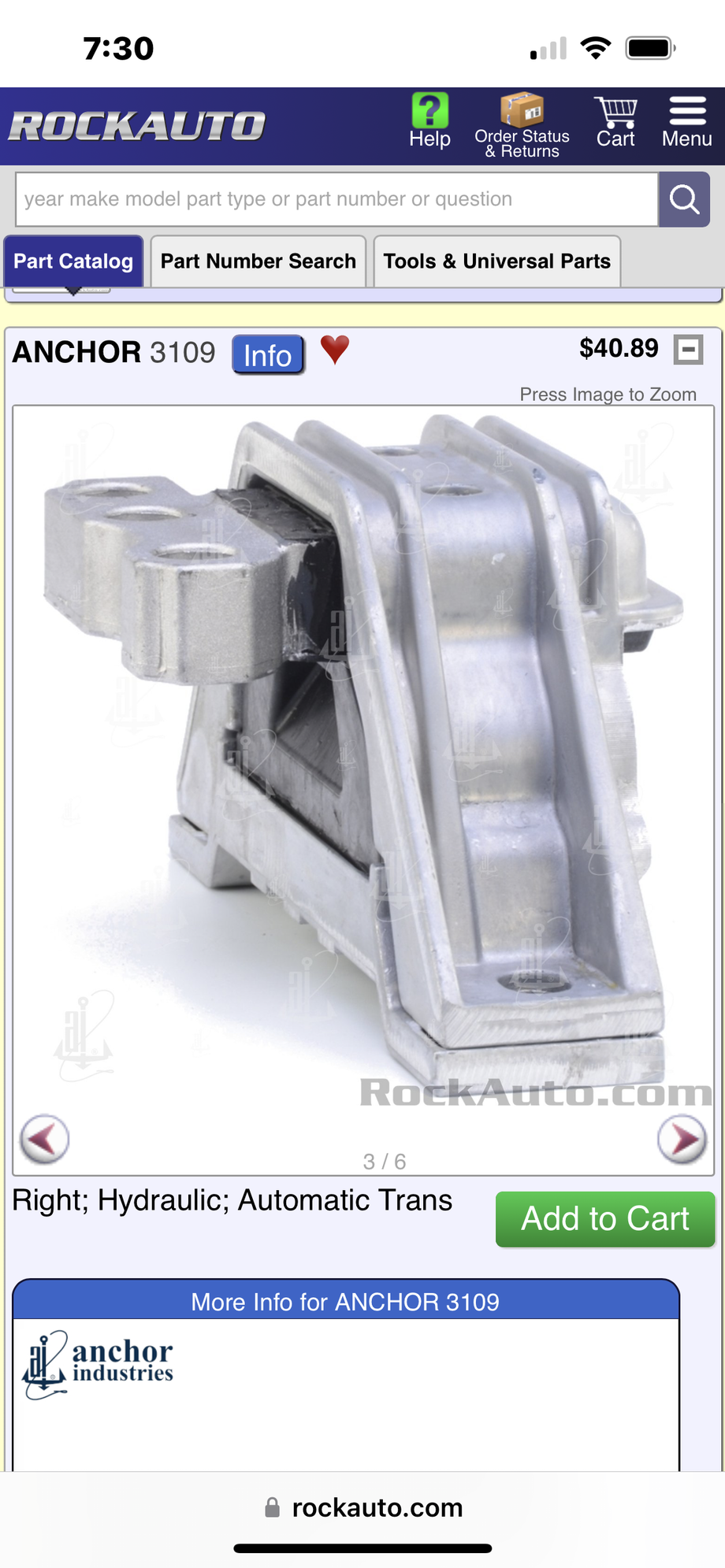

RA ships, Amazon ships , EBay
I have an Anchor 3109 the one for automatic transmission. it works
google the part number and choose
