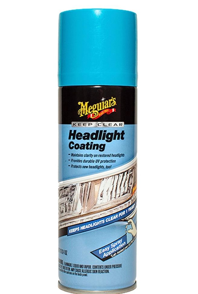

I have used this stuff. Makes the polish job last a year or two, then easy to renew.

You left out the part about the first layer of the plastic is a kind of membrane that protects the lens from UV. It needs to be replaced with something, like the product PulpFriction posted. Once that is gone you will need to continue polishing.

Once you've sanded and polished the coating and maintaining it is vital.
Replacing lenses with aftermarket ones seems the quality is not there and the deterioration from sunlight is sooner the OEM.

Clearcoating is an option but not every product is compatible. Polycarbonate is very sensitive to chemicals. 2-part clearcoat is an option, dunno if that's trouble free.
