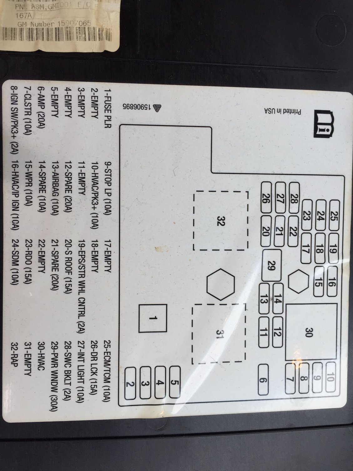

Old Mar 9, 2018 | 02:40 PM
Posts: 39,972
Check # 10, 16, and 30 fuses on the interior fuse panel on the passenger side of the console, jut pop the door off

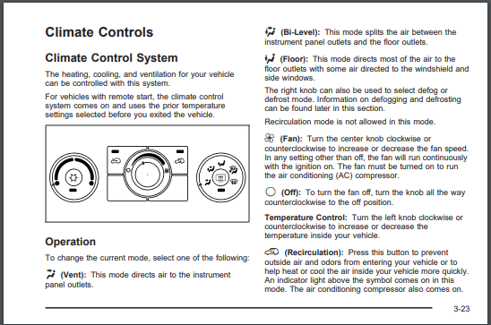

Old Mar 9, 2018 | 03:17 PM
Posts: 26,480
You have got use a few more words please.
What knob are you turning? Have you read the Owner Manual regarding using the HVAC system?
Actually it is relay #30 on that fuse box and fuse #3 in the underhood fuse box that controls the fan, if that is what we are talking about.
Here is the relevant part of the Owner Manual, note there are 3 knobs and 4 buttons, please be more specific.
Old Mar 10, 2018 | 09:51 AM
Jens2008chevyHHR's Avatar
Joined: 03-05-2018
Posts: 12
From: NB
I am turning the center knob that turns on the heat, just as I have in the past and how it came on and worked before - but does not now, I have the left dial at the highest heat setting and the right dial on defrost/heat to the floor setting, the middle dial when turned on does nothing now !!
I will check the fuses today and hope that is what the problem is, the manual does not give much info on the heating and problems with that.
