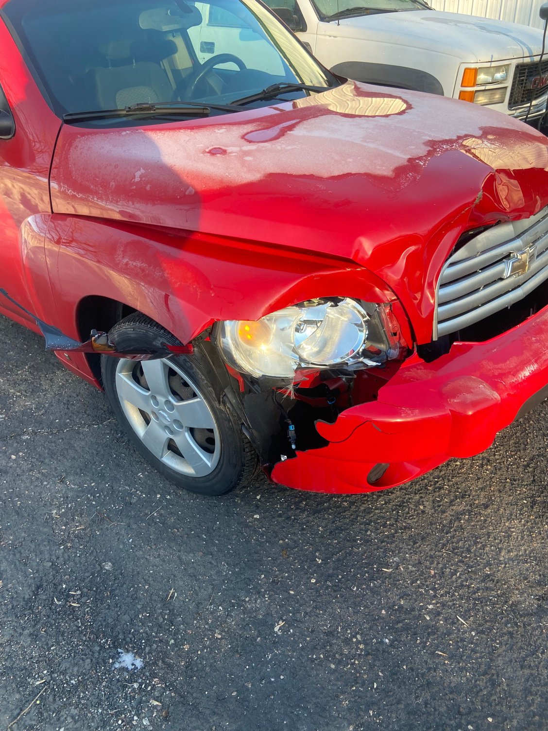

Reason for asking is that the on I bought in June 2023 just hit a deer. It has 120000 miles and is a 2009. I am thinking that if I am removing the trany cover on the side I am 75% to pulling the whole thing out. Looking for your thoughts.
This is the deer.
