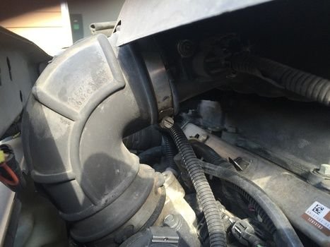

Brought it in today ez fix said the mechanic, a piece called the. horn came off the throttle body. Thanks guys

this rubber elbow being the horn.
