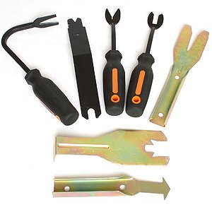

Take your pick, door panel removal tools.
Do a Search there have been door panel Diagrams posted were the "Pins" are located. Use the tool to Pry the pin piece out.
It its Warm out were your located you try just pulling starting at the very bottoms to pop them out.off, But I do NOT really recommend that method. You could break the clips or Worse the door panel were the pin clips fit into.
