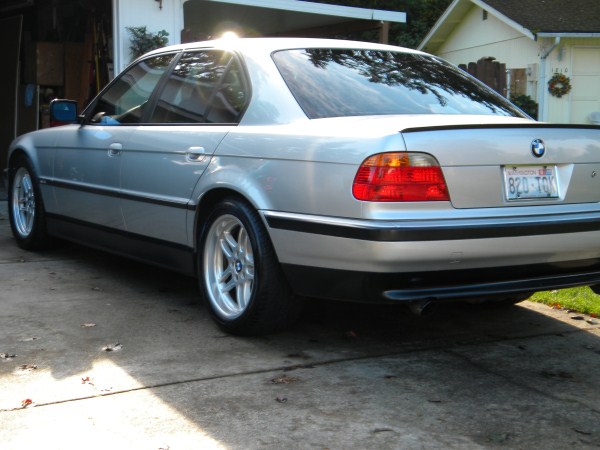

The BMW is 13 years and 180,000 miles, think I should change it yet ?
like the HHR it's in the trunk, takes up half of it, but there is still room for 4 bodies!!!
