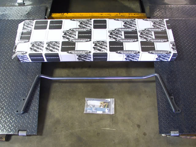

This is what your package should look like if's it's a Progress Tech.
Very large heavy box with sway bar and a bag of parts.
Mine came with instructions when I bought it from Mike.

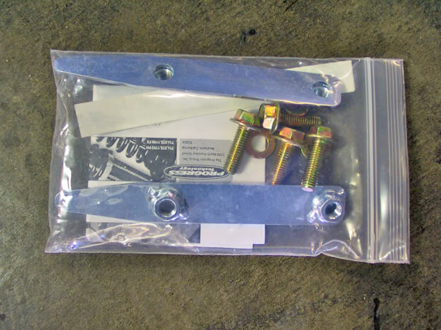

Hardware needed to install the sway bar.
(oh lookie there...there's the directions inside that plastic bag)
Ladies will read them...guys will do the macho thing and set them aside.

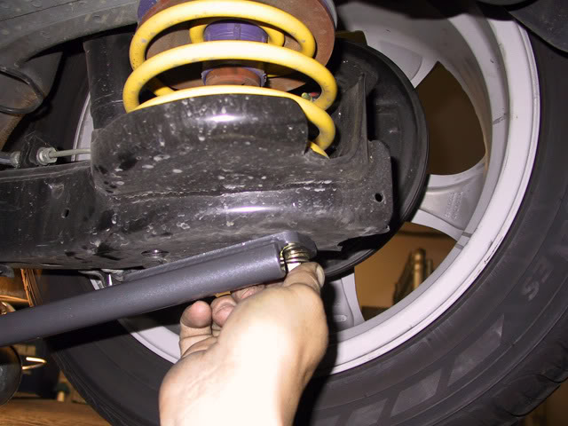

Henry and I backed my car up on ramps and that made it much easier to install.
It is recommended to do it flat...
but when you are in your early 50's like us,
you don't fit under the car like you used to.

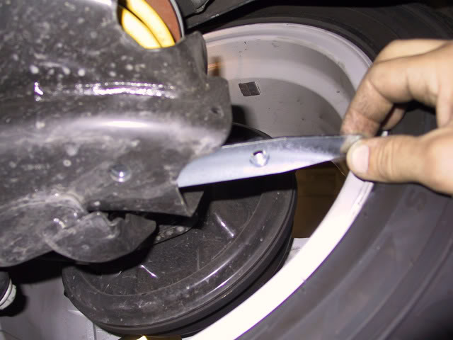

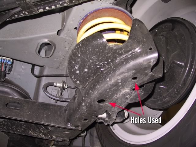

Easy part is finding the holes where the sway bar will attach.

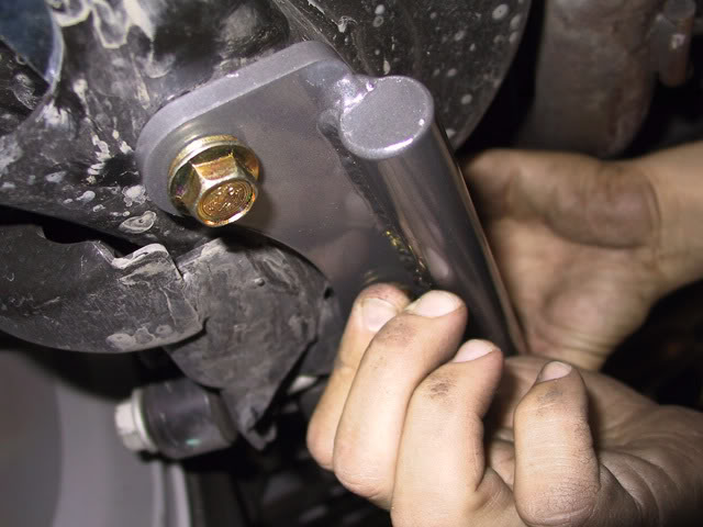

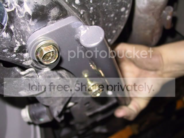

Then slide the piece that the bolts will screw into above these holes
and line it up as best you can.

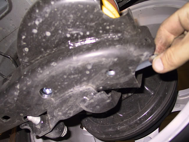

This can be a little tricky when putting the bolt and washer on,
cuz the dang thing moves.
Insert bolts and hand tighten.

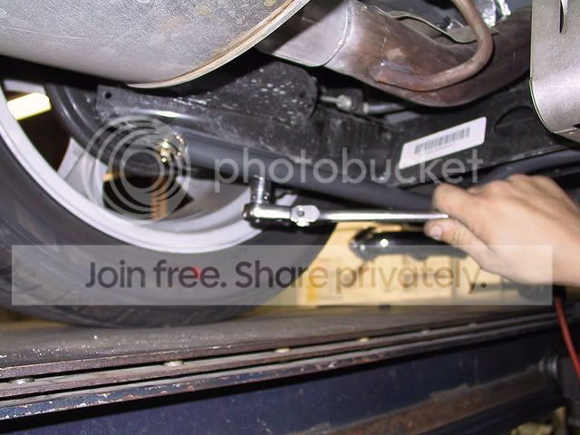

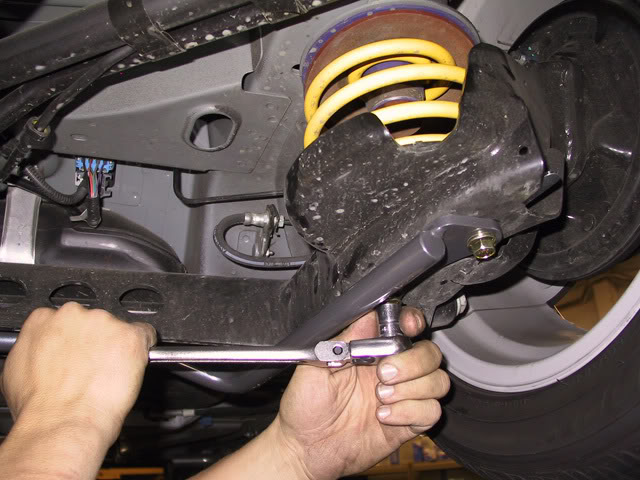

Tighten the right side with torque wrench to 45 ft lbs.

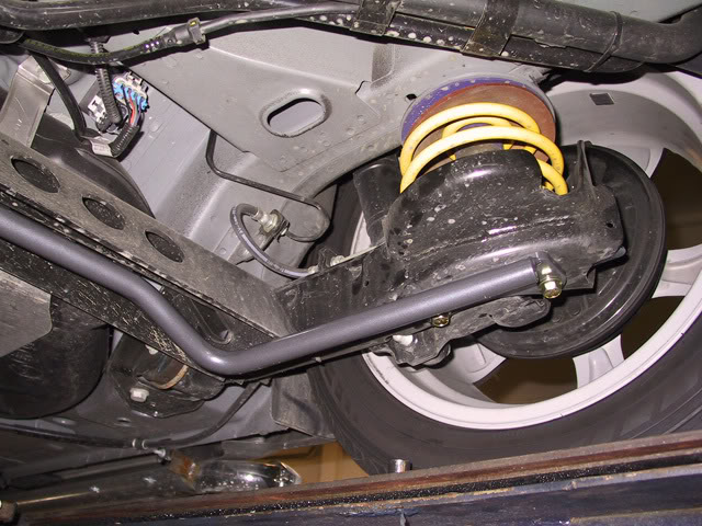

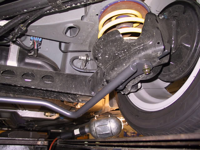

Tighten the left side with torque wrench to 45 ft lbs.
You are now done...take that mean machine of yours out for a spin
and check out the difference in the ride.
