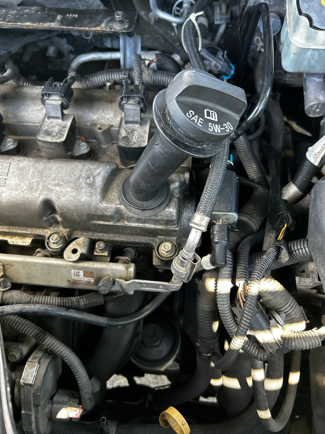

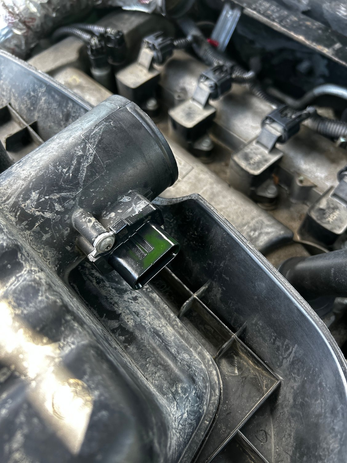

Here is a picture under the engine shroud of the MAF connector.The green fluid "spilled" out when I removed the harness connection. Most of it spilled into my hand as I was disconnecting it.You can see everything is dry elsewhere. The other picture shows how dry the engine is overall. If you look where the O2 sensor is you will see zipties. I (and mechanics) have tied up the O2 harness and connector every way possible to prevent it being "splashed" on. But it always fills up and there is never any sign of the goo anywhere else. Besides the goo just appearing, its bizarre that it would only appear in these two isolated places. When I replace these two sensors and the car runs again....because it will.....I will take pics of the green goo at the O2 connector.as it fills up again.... because it will.

P0420 is the #2 o2 sensor saying that the cat is not doing its job.
That green goo looks like the wrong kind of anti-freeze. The right kind is Dex-cool which is orange.O2 sensors have a hole through them.
Have you ever checked the coolant level under the pressure cap?
