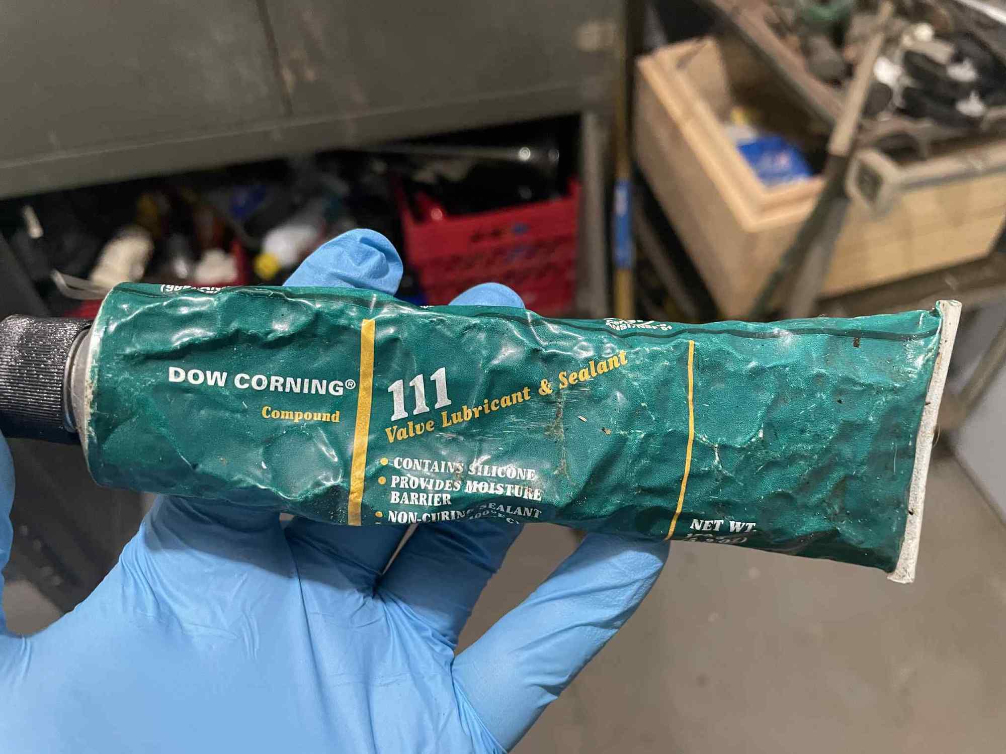

This is what ive had for the past 20 years ( got large 2 tubes of it ) from when I worked tap and meters installing Ramar Boxes on meters to read them. Ive been using it on all my electrical connections and bulb sockets to prevent corrosion and never had an issue. The stuff is really thick and does not dry out with age, Ive even used it as lubricant on power equipment exposed to weather ( brake lever shafts...ect... )

As I said: read the ingredients! Issues I am talking about are with O2 sensors and catalytic converters, not electrical connectors. I thought that was clear.
I think I've had a couple of smaller tubes of that stuff for some thirty years. Extremely stable apparently. In a pinch, I wouldn't hesitate to use it instead of explictely dialectric grease. Except, for salt water marine applications, would use only products specifically for that. Oh, wait, many of our cars are soaked in salt water in the Winter…
I think Donbrews warnings about silicone are apt. The stuff is amazing but under certain circumstance can cause nightmares. Paint problems in particular.

If you read the wiki link you will find out how dielectric grease improves conductivity. Short answer is it polarizes so the part that causes corrosion is blocked.
After thinking about it a bit, All dielectric contains silicone since it is a semi-conductive material. The actual difference is that some are really RTV.
Still, avoid the possibility of getting silicone anywhere near O2 sensors or catalyst. The sealant that comes with O2 sensors is actually glass beads that melt in the high heat of the exhaust and flows into the voids. (I guess that makes it "made with silica", notice silicon vs silicone vs silica) Maybe I used the wrong words.
yup and when others said "connectors" you said itll ruin O2 sensors ( how when its on the connectors, not the fitting/flange ? Just so you are very clear.

I was forgetting that the sensors on the HHR have a pigtail.
