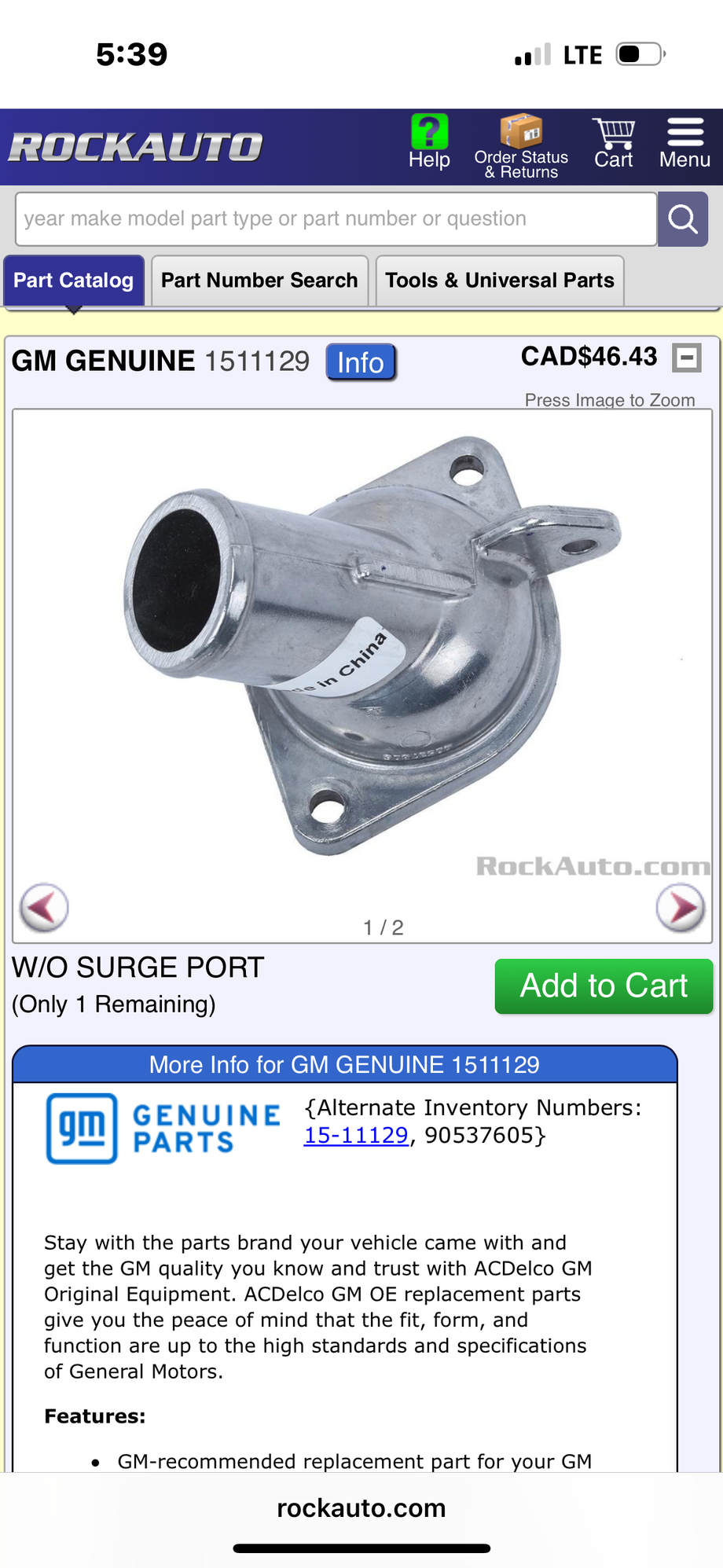

Old Jul 25, 2025 | 04:41 PM
Posts: 40,083
Thermostat housing without the surge port and rubber cap
Old Jul 25, 2025 | 05:03 PM
Gearhead1's Avatar
Joined: 04-27-2021
Posts: 570
Thanks….will check into that
