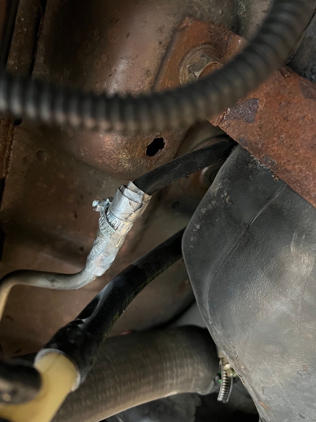

The company I manage has a 2011 Chevrolet HHR as a work car. We have maintained the car regularly and never had an issue (I believe it was purchased approximately 2014). We were told the fuel lines had rusted. We had the fuel lines replaced. The problem we are having though is that the connection from the fuel pump to the lines is leaking. The shop that we use to maintain the car says they called the dealer and the part needed is no longer made. I don't know if that is accurate or not.
I did research after the shop said the dealer doesn't have the part and purchased this aftermarket kit:
https://moderndaymuffler.com/product...word=QFF0015SS
When I ordered the kit, I asked if the kit includes all connections necessary including to gas tank (the shop described the part leaking as the part that connects to the gas tank). I was told that it does include all parts for the fuel system.
I provided the kit to the shop and they told me this kit is just the fuel lines and does not include the piece that is leaking. In the picture, the silver metal is the new fuel lines. It apparently links to the black line on the right. I was told that the "connector" doesn't fit and they tried to wrap it but it still leaks. Can someone please help me to get the parts needed so that we can use the HHR?
Any help greatly appreciated!

This kit includes from the fuel tank bundy to the engine
https://www.inlinetube.com/products/nfr0019
The fuel line to the tank has a female quick connect fitting It appears in your photo that piece is missing where the gear clamp is. Dorman has those available to replace that 3/8 connection

Regarding your answers, am I understanding correctly that I do not need the nylon kit from inlinetube.com (though that would have been the correct kit to purchase initially) and just the Dorman adapter listed in the Dormanproducts.com link?
Old Aug 30, 2024 | 07:35 AM
Posts: 40,003
Correct , just that Dorman fitting, and a tool to install it.

Oldblue, just wanted to update here that we were able to repair the HHR using the Dorman fuel line quick connector link that you sent. Thanks so much! Really appreciate it! If there is a way to tip for someone’s help please let me know.
