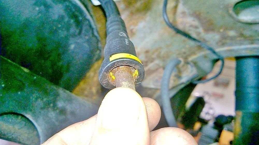

The shop that did the fuel line work (that I no longer trust) says that the repair done the first time it wouldn't start was:
Fuel flexible hose was leaking from fuel tank side and technician fixed that one
Is it correct to assume there is only 1 flexible fuel hose to replace or is there more than 1?
Old Sep 27, 2024 | 05:58 PM
Posts: 40,001
That flex line from the fuel pump to the fuel line is obsolete, you have to fabricate a new line with the Dorman fittings and vinyl flex line 3/8 or 10mm .
That’s the flex vinyl pipe that goes to the fuel pump

thanks so much for the follow up! Car is working now finally! I greatly appreciate all of the help here!
