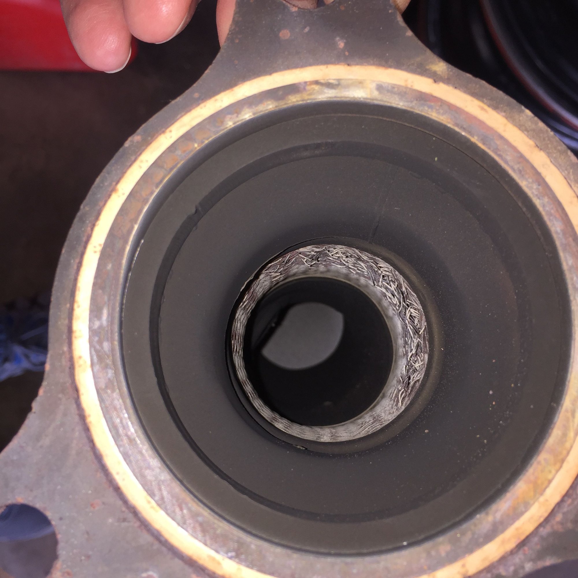

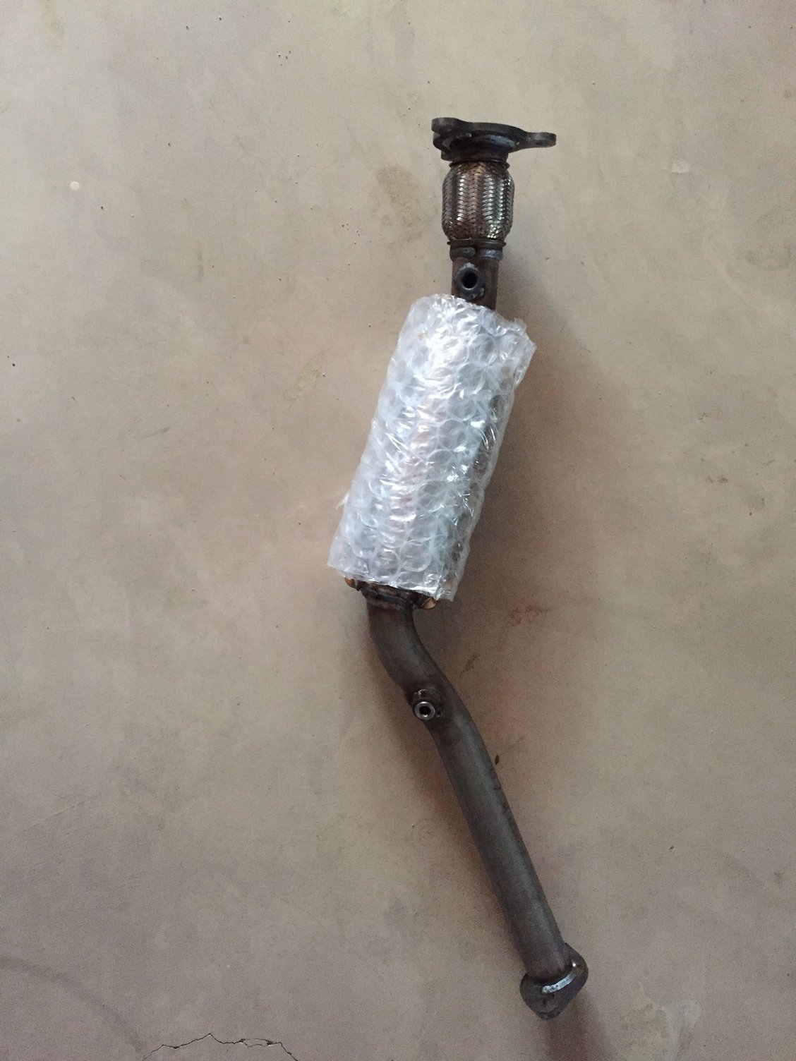

Here’s pictures of mine
The flange in the end of the catalytic converter down pipe, gasket still stuck on.
The exhaust manifold end, has an o ring groove and braided gasket

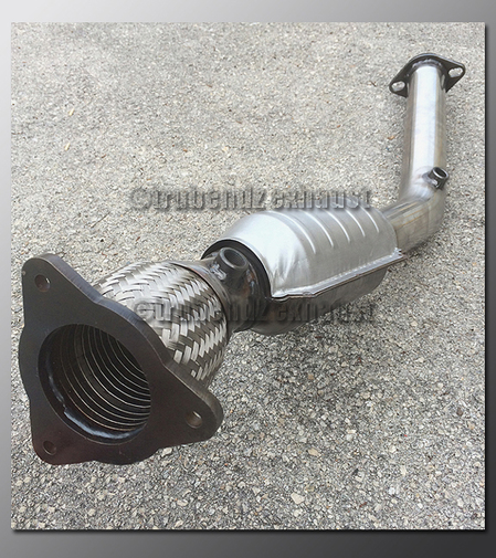

If you are going to start replacing the exhaust you might want to look at this web sight. They have what you will need and it bolts right up at a good price. As you can see they have gotten rid of the GM restriction at the flex pipe on the down tube.
Mandrel Exhaust Systems

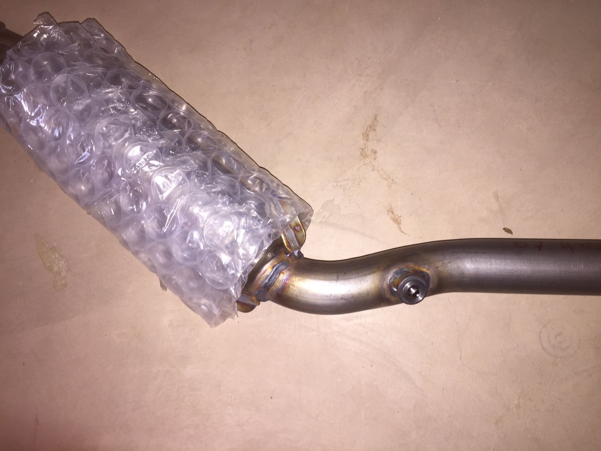

I replaced mine with this , 2 inch stainless steel mandrel bent piece
https://rover.ebay.com/rover/0/0/0?m...2F192419804833
It helped my 2.2 catch its breath and run a touch better
Mandrel bent 2 inch tube no kinks
This bend is were you see a kink in the OEM pipe

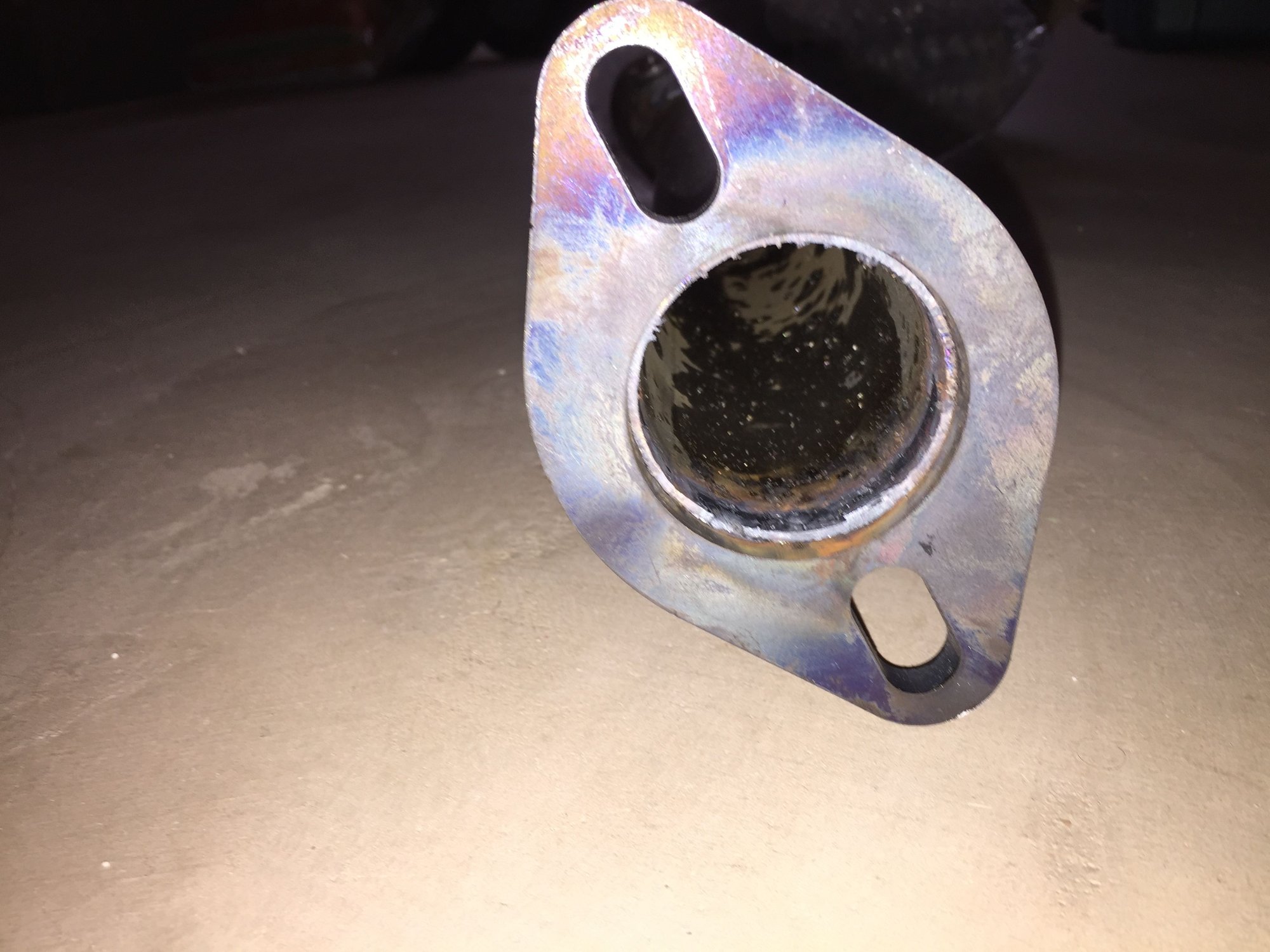

A Venturi flange to direct exhaust gases
A 3/8 thick flange with a full 2 inch hole not the 1 3/4 inch OEM hole in the flimsy 1/8 factory flange
