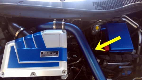

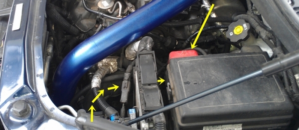

Ask and you shall receive...
the t-stat is buried under the nest of wires here...the smaller arrows are the coolant hose...
the t-stat is at the tip of the arrow...probably 12 inches towards the ground

OK, if I am reading everything correctly, your thermostat appears to be in the same location as the 2.2 and 2.4. Although ours may be a little closer to the ground and almost under the firewall.
Maybe looking up part numbers for the hoses and thermostat and comparing diagrams would help.
