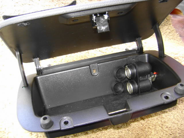

Rather than tap into an existing circuit and run the chance of a possible overload you can tap directly into the fuse panel on the right side floor area of the passenger side.
There are several blank fuse positions available. If you want constant hot use position #28, if you want it only hot when the key is on use position #21.
Run your wire, with a inline fuse, up to the top storage area and either connect directly to the power cord of your devise or into a single, double or tripple outlet so you don't have to cut the end of your devise cord.
I put a double outlet in there, one constant and one key controlled before I added several more devises and moved them all down to the floor behind the waterfall area.

Found a pic to explain better....
