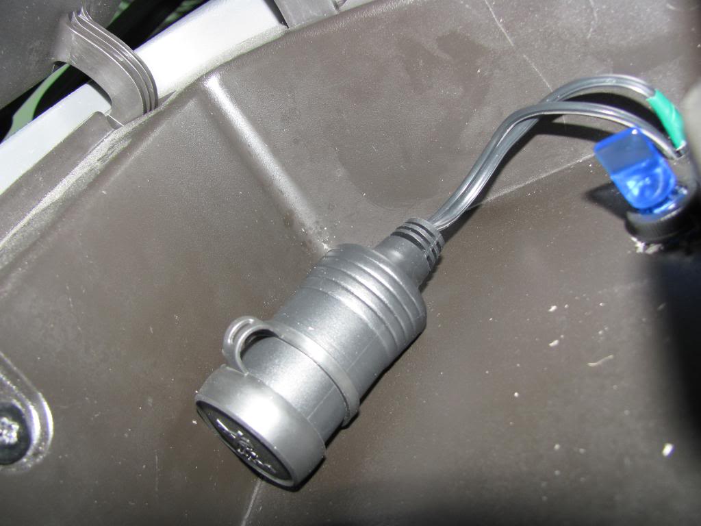

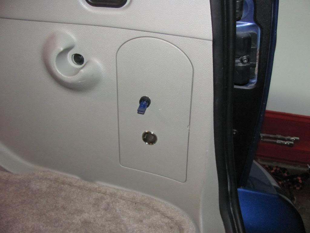

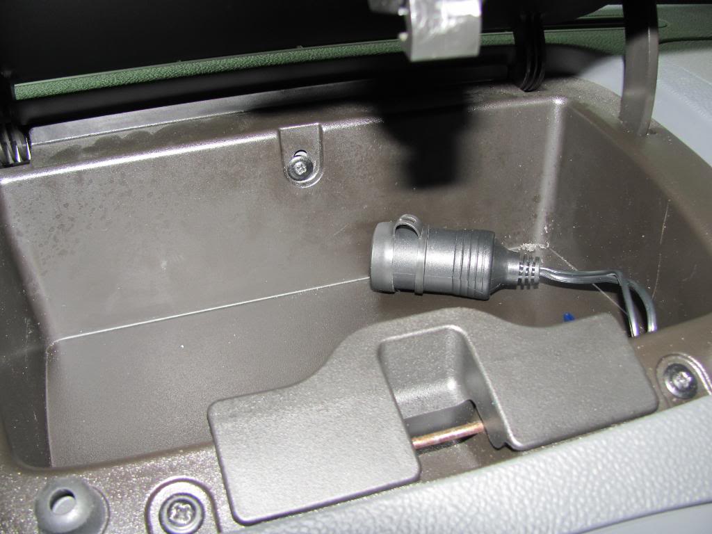

Thanks for all the replies. I ended up adding 2 outlets....1 in the front cubby, and 1 in the rear hatch. I hotwired both, but also wired in switches so I can turn them on and off as desired.
Rear:
Front (hard to photograph):
Now, I just have to figure out a mount for my GPS in that front cubby
Old Jan 17, 2011 | 07:53 PM
Gas Man's Avatar
Joined: 01-04-2010
Posts: 1,584
From: Imported from Detroit
I like that. But I would go with a more flush mounted rocker switch so you don't break it off loading something.
Old Jan 19, 2011 | 05:12 PM
secondhhrw's Avatar
Joined: 05-02-2010
Posts: 23
From: Chicago Heights, IL
You beat me to it. Weekly groceries would snap the switch shown off in a minute if it was in ours. Before that happened the load would probably turn the switch on, though.
Old Jan 19, 2011 | 07:01 PM
weekendwarrior's Avatar
Joined: 12-19-2010
Posts: 13
From: Charlotte, NC
Hmmm....For my purposes, I didn't really have to account for the switch getting hit. This is my Monday - Friday, decent gas mileage, daily driver. If I am going to haul, I typically use my SUV (and cargo trailer if the load is that large). I can't say that we ever get enough groceries at a time for that to be an issue either. Typically, 4 to 5 plastic grocery bags worth of food holds me and my wife for a couple of weeks.
The main reason for adding it in the rear was for my portable air compressor. Thanks for the feedback though....at least a switch is a 5 minute fix, if I need to swap it out for a low profile one.
