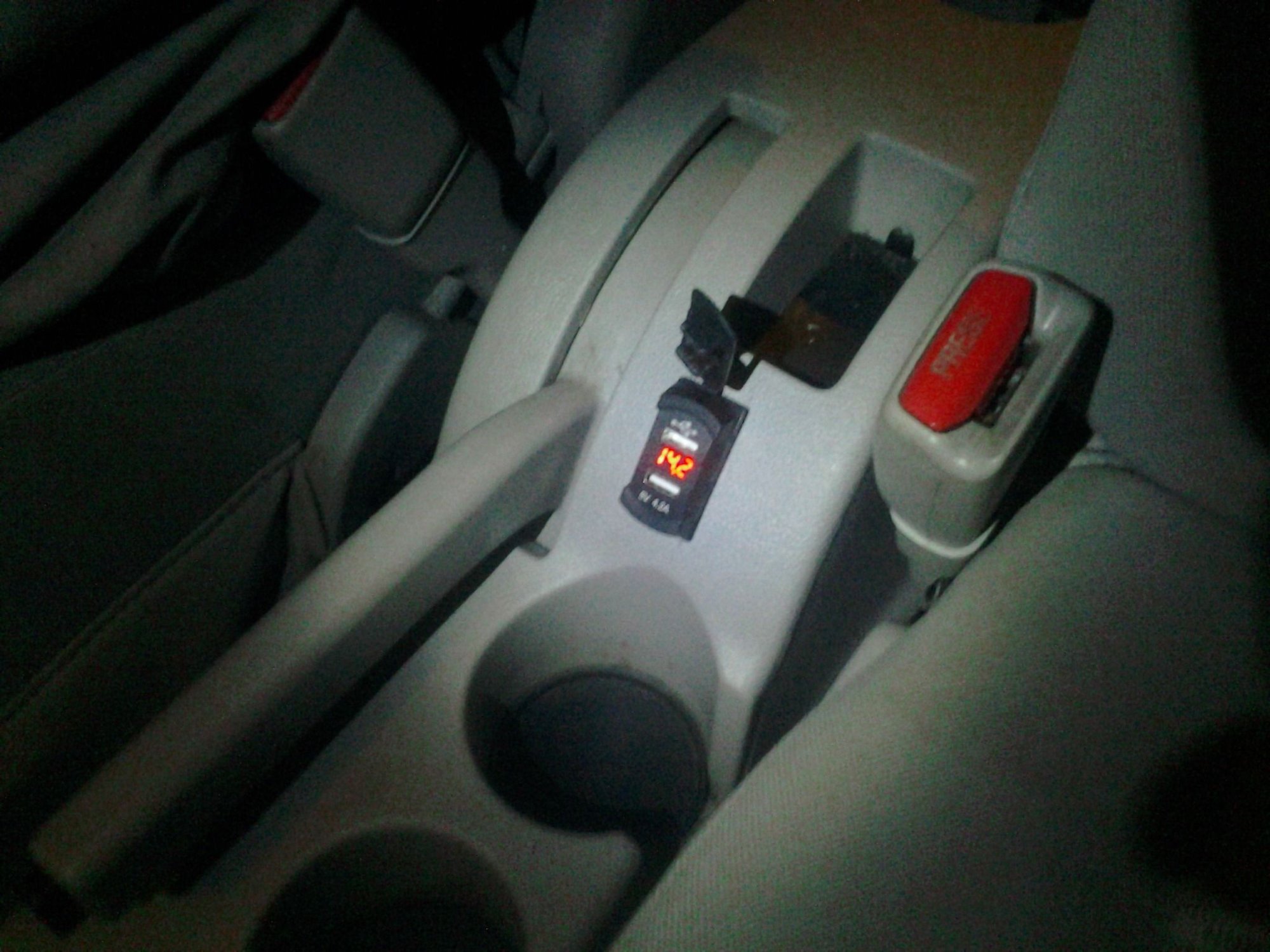

I installed a dedicated USB port in the console by the cup holders today and while i was in there i went ahead and did the purple wire ground thing. My car does not have the AP3 code but does have "remote start - on" in the DIC. With hood and doors closed i hit lock button once (doors lock) then hit lock/panic and some dash lights come on briefly and something cycles in the back of the car (sounds fuel pump-ish) but then all cycles off but no attempt to start is made by the car. Going to read up on the thread a bit more, car does not seem to have any other issues with the wire grounded so i assume i did the right one. Purple one third over from the far right on the top row in that blue multi gang plug.

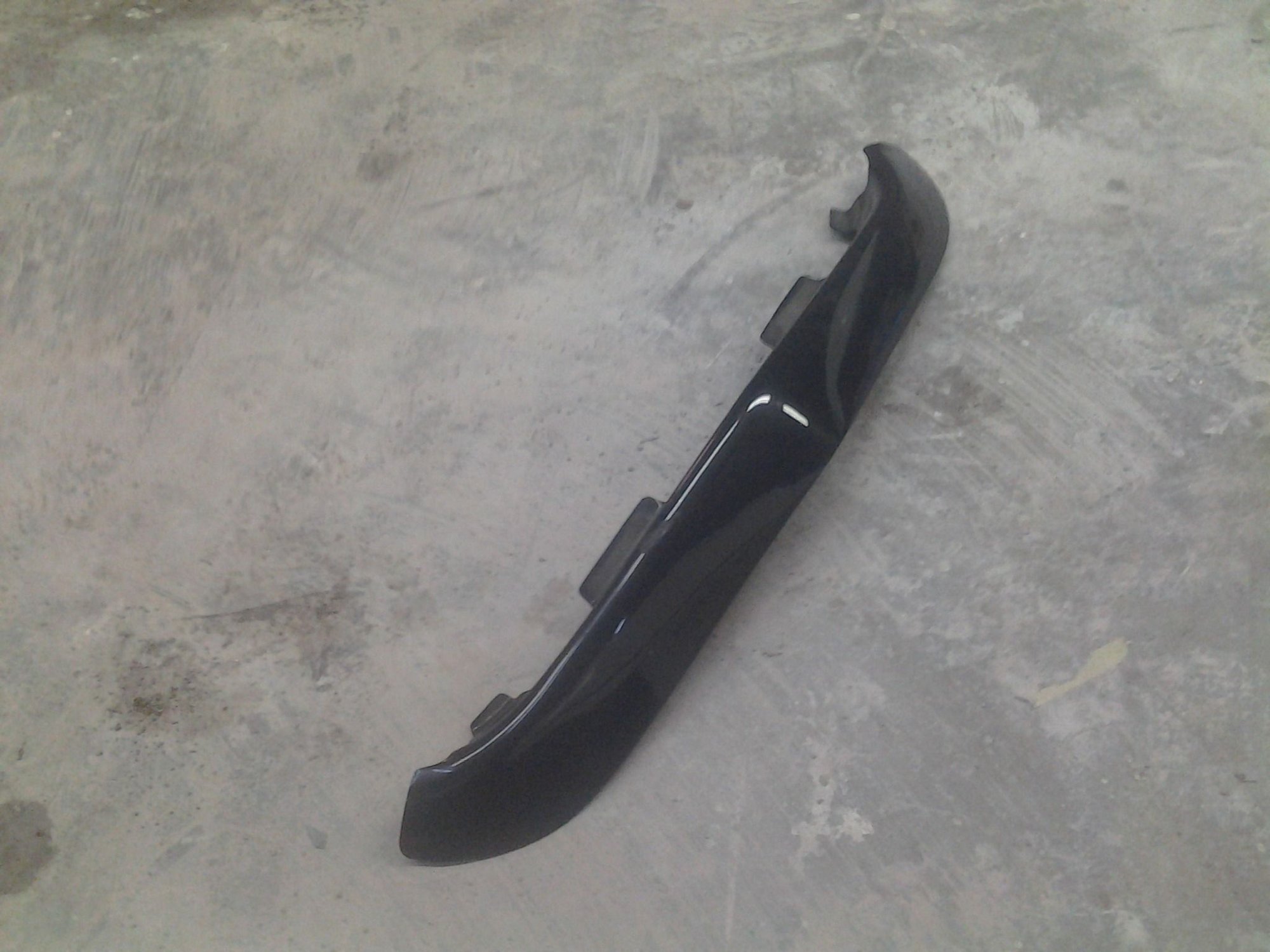

anybody want a bug guard? its free just gotta pick it up or pay postage, took it off today didnt much care for it
