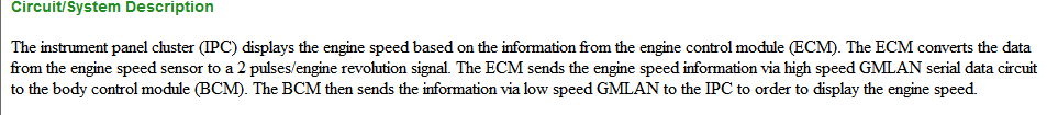

Are you sure that that is where the tachometer gets it's signal? You have low speed LAN and High speed LAN involved.

i am not so sure that the cranshaft position sensor has anything to do with the tachometer.
