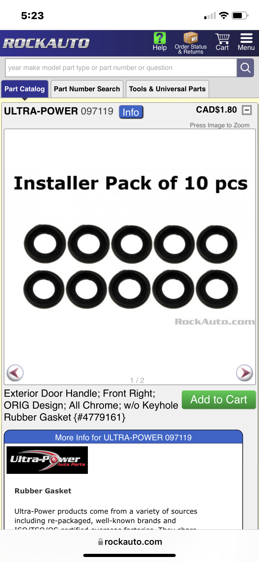

Posts: 40,083
Like these at RockAuto?

Posts: 40,083
Me too, but they are available. For future readers.
