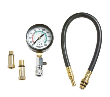

This is a compression gauge
hold off on the fuel pump, remove the spark plugs
remove the fuel pump fuse in the under hood fuse box #13 , I believe
your cousin should know how to do a compression test.
all 4 cylinders should be within 15 % of each other, 150 to 180 psi.
write the numbers down and post them here.
get the AC Delco plugs and install them after the test.
