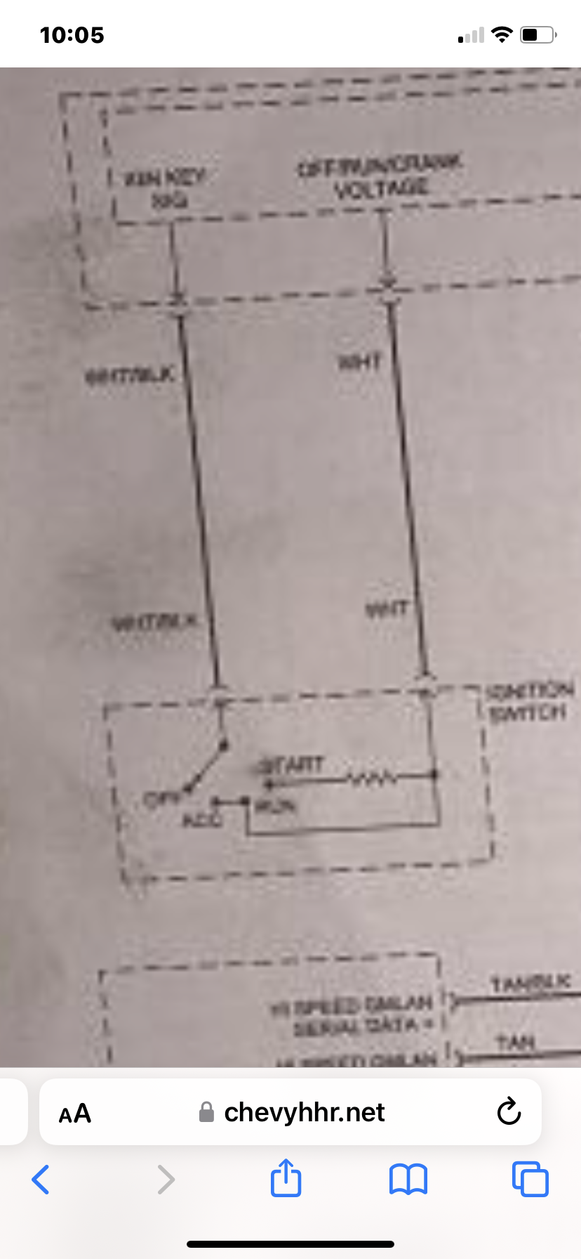

could someone tell me where to find the wires to tap into on hooking up a push button start

on the switch cylinder.

The ignition switch holds all the positions within the switch ACC , RUN and Start. A push to start button would simply replace the existing start temporary function of the switch.

You would need to get the value of the resistor.
Been done and posted here:https://www.chevyhhr.net/forums/audi...n-start-21570/
