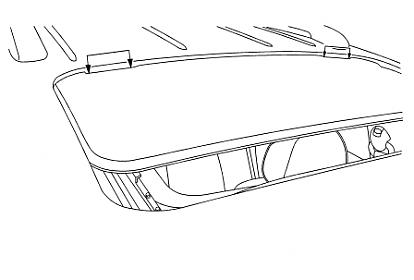

Only 2mm is filed off the downturn flange on the rear of the roof. A metal file is used and NO grinding with a grinder should be necessary. You then use touch up paint on the bare metal.
The filing is done between the two arrows on both sides. This is a 1 hour repair and no dropping of the headliner or sunroof module is necessary, they just remove the glass (4 screws).
Here is the full TSB:
Remove the sunroof glass.
Important: Protect the interior of the vehicle before filing.
File 2 mm (.079 in) off the down-turned flange.
Sand down all sharp edges.
Touch up the bare metal with an approved two-part epoxy primer before using the color touch up paint.
Refer to the latest revision of the GM Approved Refinish Materials book to identify the paint systems you may use that have been engineered to meet GM standards. The GM Approved Refinish Materials book supplies all approved products, including volatile organic compound (VOC) compliant regulations recommended by the individual manufacturer, and detailed procedures for materials used in their paint system. The latest revision of the GM Approved Refinish Materials booklet is located on the Goodwrench website at www.gmgoodwrench.com
Reinstall the sunroof glass. Refer to Sunroof Window Height and Opening Fit Adjustment.

What would you recommend if my dealer said it is a 3 day thing? Another dealer?
I would call them and say you found the TSB on the internet and were wondering why they needed the vehicle for 3 days, since the total labor time allowance is 1.0 hours. If they still stick to their plan I would call another dealer.
Originally Posted by turbotim
I took my HHR into the dealer (only one within 30 miles) with this concern. They said they could not replicate the problem. I brought it back again and they applied some spray lubricant on the rails. Still does it. Could you post the number for the TSB so I can bring it into my service manager?
TSB # is 08-08-67-004. I can email a copy to you to take to them if you like. Send me a PM with your email address.
