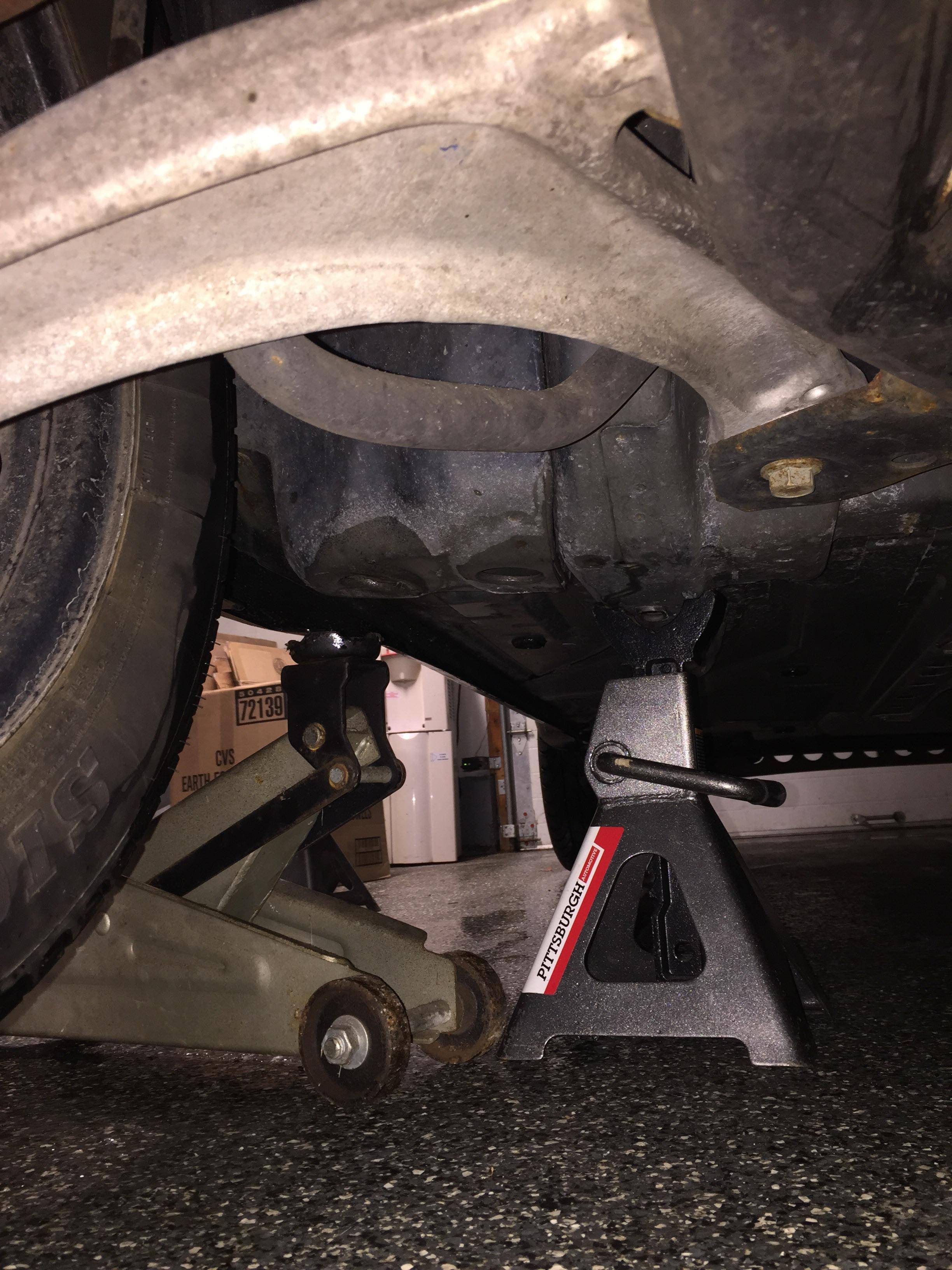

Just did the same thing , what's up with that misleading drawing Name:  08wpb6d.jpg
Over a year later but really

I put jackstands at the flat spots on the front horns.

There are frame rails, well the unibody equivalent, that run front to back and are thick layered steel. In the above pic the stand is on it. I use that for jacking and put the stand right next to it on the rail.
