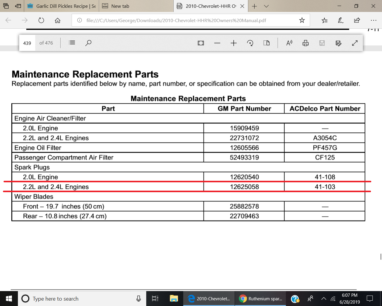

That part number is for the SS. Not at all sure it's right for other motors.

Thanks for the tip Blue ! The coil packs seem to be fine so I see no need to change them now ! Could I use a tiny bit of anti seize on these ? I know some plugs are already cooated and it is a no go on anti seize !
I'll double check that #.. Thanks for the tip
Just looked at Auto Zone and show the same plug for the 2.2
?? Think you may have that wrong. He did say 41-103 which is for the 2.2 and 2.4.
