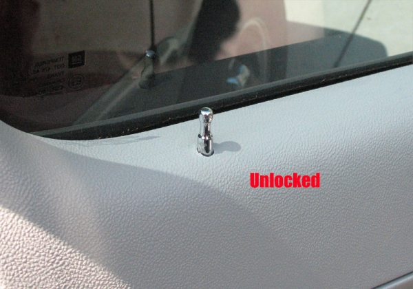

IS there any way to modify the factory shaft so that the locks dont pop up as high??? ...and also isnt haggered looking
Old Apr 25, 2007 | 09:23 AM
SICKS.OH's Avatar
Joined: 12-02-2006
Posts: 160
From: FL
yeah. i pulled the knob off, and used a dremel cut wheel to trim the "shaft" off. i think i took 3/8in basicly used needle nose pliers to hold it, and cut what i could off. i also trimmed the knob a little bit.
Old Apr 25, 2007 | 09:36 AM
JoeCanadian69's Avatar
Joined: 03-29-2007
Posts: 43
From: Sarnia, Ontario, Canada
So does the pop-up that sticks out of the door have a hole on the bottom that a rod from the actually Door lockset goes into??
Old Apr 25, 2007 | 10:21 AM
  #26
Yes, the factory knobs are hollow, and the rod inserts into knob.
Old Apr 25, 2007 | 10:30 AM
  #27
SICKS.OH's Avatar
Joined: 12-02-2006
Posts: 160
From: FL
Old Apr 25, 2007 | 12:05 PM
  #28
Joined: 03-29-2007
Posts: 43
Ahh i see!!! awsome!!
