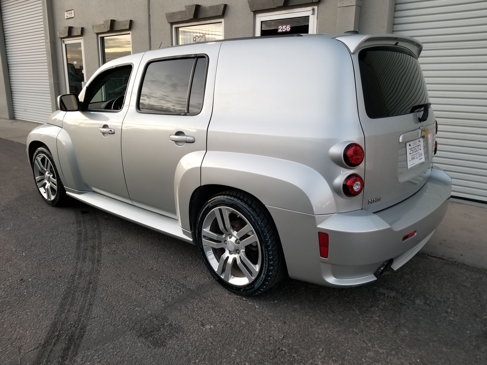

I bought mine a couple months
Ago I never checked anything it was parked for 6 years looked at bald dry tires and replaced them then a squeaky belt faded paint and lights. changed oil and threw it in a bodyshop and bought new lights 3 tickets later still runs good just ordered intake,catback,tune from trifecta etc
These seem to be pretty decent cars and parts are cheap but like anything they are used and bound to need some work
Mines a 2009 auto and it has 112k Miles on the dash I paid 3500 for it then 600 paint 300 tires 200 tail lights 80bucks headlights 110 for a windshield really are fun to drive just stock mine also already had GM tune I was able to tell from premium fuel sticker on inside gas cap then verified with map sensors.
Its had some emblem updates since these pics,and paint correction and ceramic pro coatings but you get the idea.
