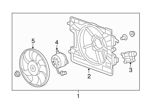

I realize this is an old thread but does anyone have a photo of where the module is located on a 2008 HHR SS? Found one on Amazon for $122. Looks like a simple two- or three-plug device.
Old May 17, 2022 | 07:24 PM
Posts: 26,533
It is the blocky black plastic thingy with wires going in and out mounted on the fan shroud.
If you can find more than one thing with wire going to the fan motor you are not looking at a HHR. Maybe should phrase that as "there is only one set of wires going to the fan".
# 3 in the image. Found by GoOgling "HHR SS fan shroud". The same as posted in #10.

As explained earlier in this thread; the SS does not have a relay controlled fan like the 2.2 and 2.4 it has a PWM module instead, for an infinitely variable speed.

When my son's 2008 HHR SS fan/module failed, I bought a whole new assembly (fan with control module) from Rock Auto for I think $170.
I was concerned that the fan might be failing and drawing more current, which could take out the new module.
