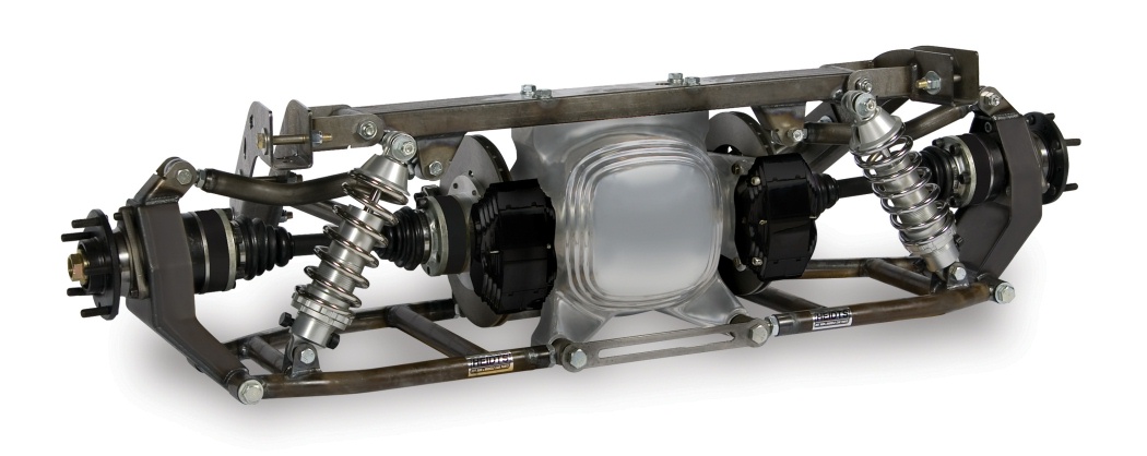

Heidt's has this it maybe a little wide, it retro fit for GM A body cars from the 60's

That's a nice piece reminds me of a XKE Jag rear. I would like to think an IRS could be used from another manufacturer that use's front wheel drive.

Or the rear axles , swing arms and pumpkin from a Honda CRV or a Mazda Tribute!
