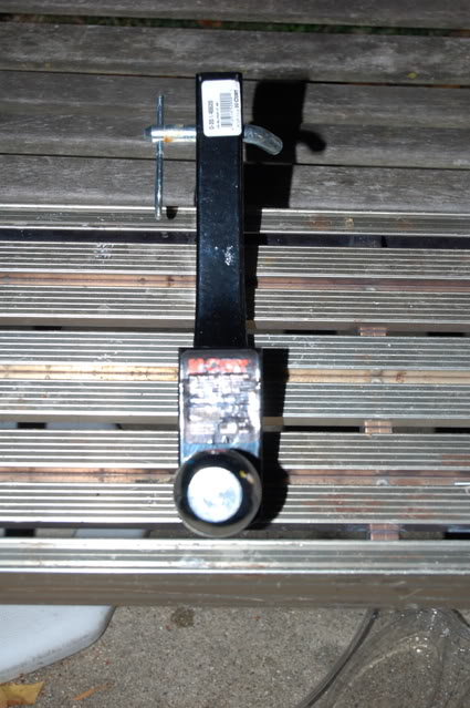

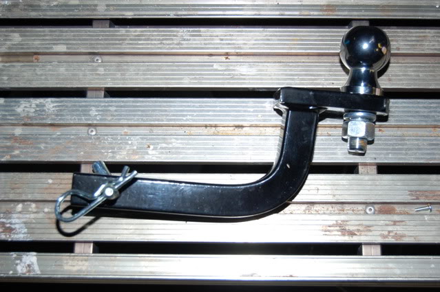

Good point. You get this one with the Curt. You gotta buy your own Ball tho.
The Curt is made extremely well, the frame will rip out before the hitch itself lets go.
