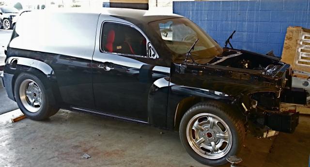

It's not a real SS
I hope nobody minds me putting SS seats in the V8 Panel. It's not really an SS. I got these seats and matching SS door panels from djPhil, one of the members on this forum. I think they look good and will blend in with the overall look I'm going for.

Really liking that "meat" look of the rear tires.
