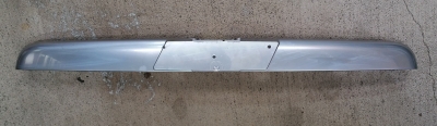

I liked your idea a lot. I'm posting the pics and instructions here. This is a really time consuming project and it costs about $200 plus the painting. It requires a complete stock SS grill assembly, an additional grill, '56 Chevy V8 hood & trunk emblems, 3M bumper repair material, plastic mesh and bondo.
Here is a stock SS grill. You will be modifying the Bowtie area only.
Here is the end result you need on the grill. You must remove the upper and lower sections of the Bowtie areas (I used a Bridgeport to get a straight, square area) Then with the material from another grill you replace this area to get a straight line while matching the "egg crate" exactly. This is difficult to match-up.

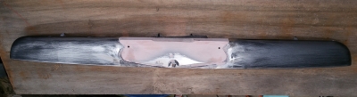

The grill bezel needs to be modified to fit the reshaped grill. Cut off the top and bottom sections of the Bowtie, and re-enforce the area with 3M bumper repair material and plastic mesh. Shape to fit. Drill 3 mounting holes for the '56 V8 emblem and build a peak out of bondo to fit the angled shape of the emblem.
The rear is alot easier. Grind the upper and lower Bowtie areas off and with 3M bumper repair and plastic mesh fill in the hole.
Use bondo to raise an area the shape of the'56 trunk emblem. Drill 3 mounting holes.
Here is the end result. It took around 15 hours of work to do this but I think it looks factory.....I wonder how many people will even notice. I hope not many, that is the true test of mods done correctly.
