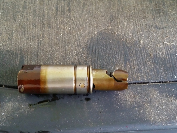

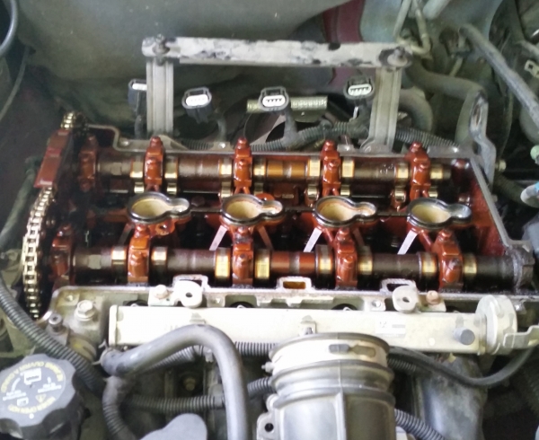

Replaced the timing chain tensioner today. As you can see it was cracked and on its last leg. I did it the right way and popped the valve covers off. I found it helpful to remove the cowl so you can get a breaker bar in there. Alittle tight on the clearance. Runs super smooth now, no sowing machine on cold start up.

A true "in the nick of time" deal there Twistedtat, just a few more miles and things could have gone totally downhill fast.

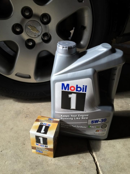

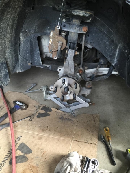

Oil change and new wheel bearings! I started hearing a humming sound a couple months ago whenever car reaches around 40mph+ (most noticeable between 40-45), so I figured it may be the wheel bearings. After a test drive, there is still humming. My next move includes replacing the driver and passenger CV axles, since both are pretty wobbly. If that doesn't do the trick, then I am not sure of the problem at hand.
