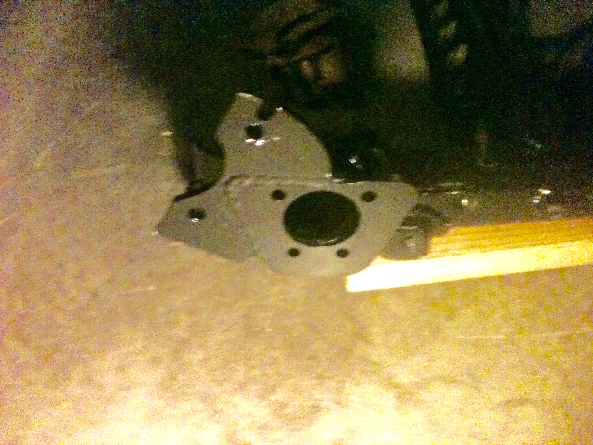

Yesterday when talking to Dave, the guy that owns the shop where I get work done, about brakes, I was mentioning the Cobalt SS rear axle swap for 4 wheel discs. He said "get one, we can put it in"...
So now I need to find one... Maybe.
I may also need to find a GMPP/Borla exhaust system.

Cobalt SS rear axles are getting hard to find. If you get one great, but if you can't you can mod your axle you have now. A mounting flange can be welded on to your axle and all stock SS parts bolt on. At 30mph I can lock up my rear wheels with the parking brake now. That is something you can't do with the stock drums. I changed mine 40k ago.
