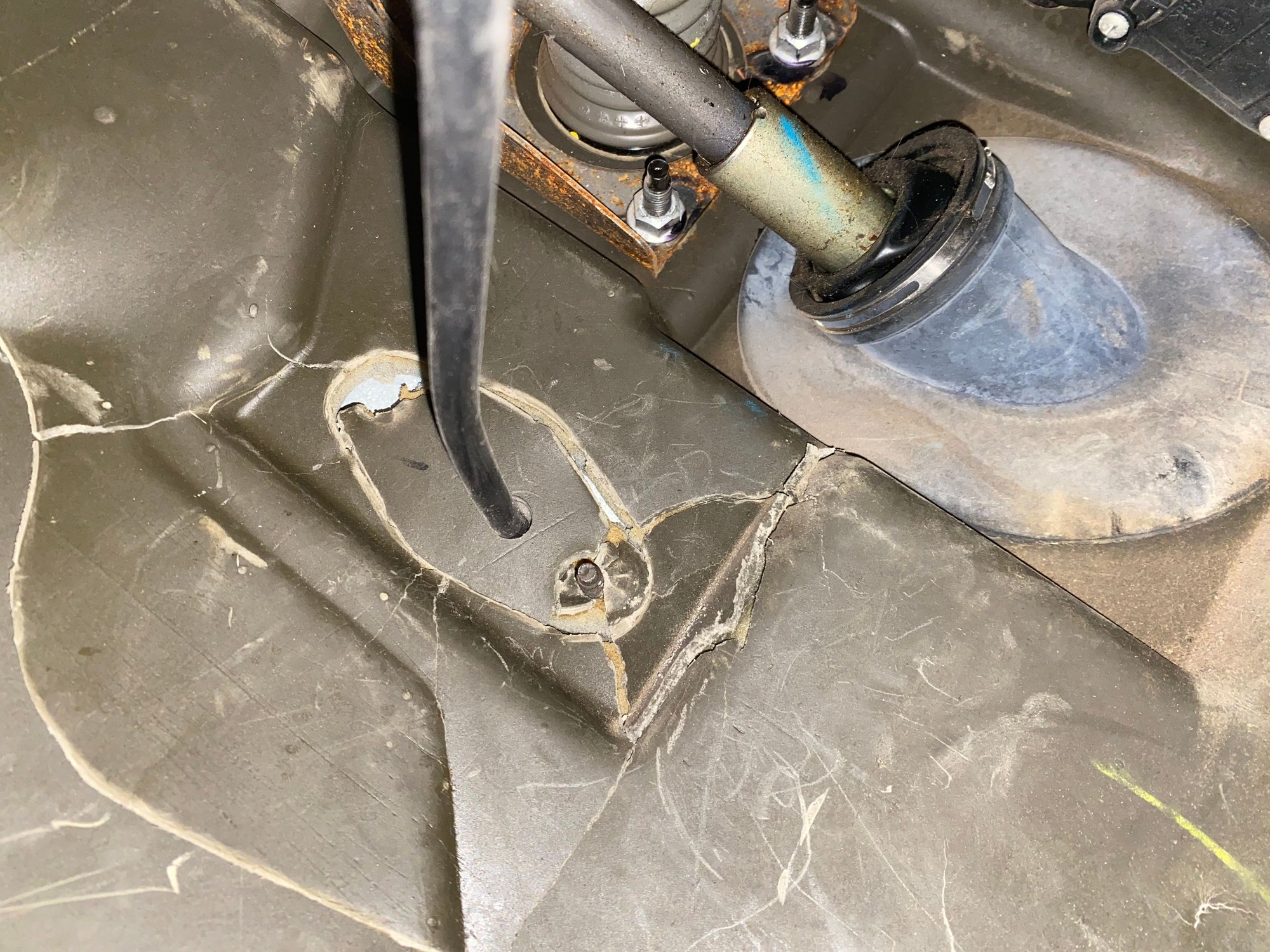

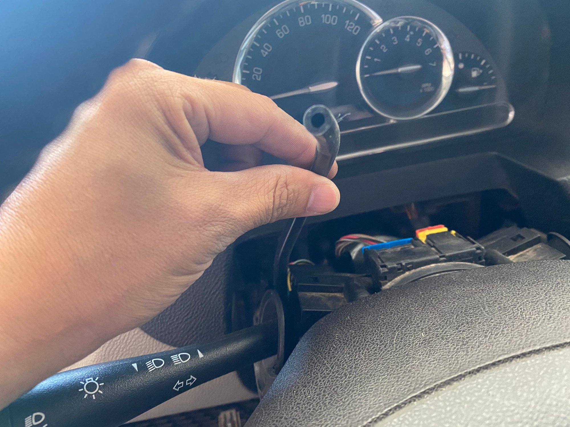

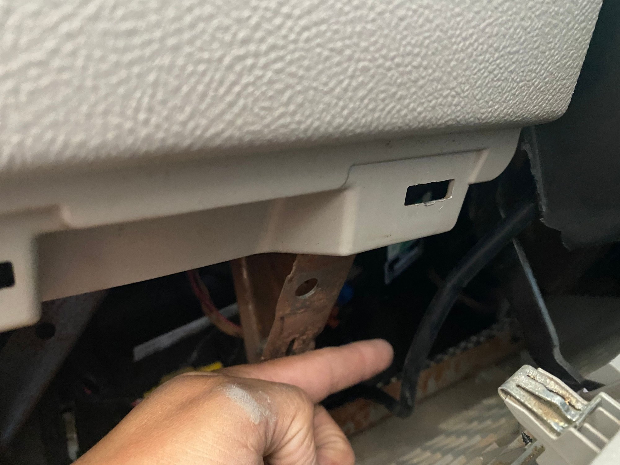

Well the other day getting my daily drive project car ready. Will be installing a S/C kit in my HHR. Is a 2.4 decided to get a boost gauge ready and routed when my kit comes in. I have done allot to this car and some may say is a waste or should have gotten a SS but what ever lol. This was pretty easy ordered the single gauge pod for steering wheel off ebay and the boost gauge is from glow shift. To route the vacuum line for the boost gauge drilled a hole through the firewall there is enough line to run it. on the gauge pod had to sand/smooth it down do the gauge could snug in. The fun part came when had to route the wires and tap into power source going to the stereo. Made sure it powers on and it did, I can switch the color of the pod display but will see once I recv the S/C kit and have it running what color will pick lol.

Nice.
You really should put a rubber grommet where the vacuum line passes through the firewall. That would eliminate any chafing on the vacuum line.

Posts: 40,068
Nice job! X2 on the grommet , FMG mentioned
