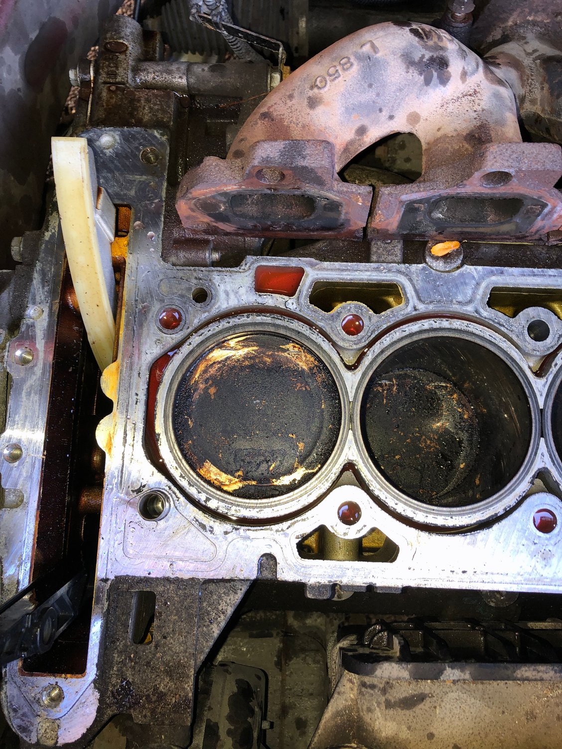

Drove to the_shmoo’s house and performed the compression test, yep, bent valves! We removed the head, no piston damage just bent valves, so, time to order up some parts.
See the exhaust valves have marks on the right
This is #1 piston, very minor marks from the valves Compression was 45# psi
This is #4 same marks, compression was 25# psi

Just jumping into Blues problem.
How did this happen ?
A.K.A. timing chain ?

Posts: 39,970
Yes timing chain problem.

Or, if the valves can't close because of being bent, that would allow you to rotate the crank with NO resistance, cause it can't build compression. .. But we'll hope for the best.. Please keep us updated, if you would.
Guess I called that one.. BUMMER.. But doesn't look too bad, lot of clean up & inspecting. Ex valves look to have hit the worst.
Blue- did chain break, or just jump some teeth ?

Posts: 39,970
Jumped
