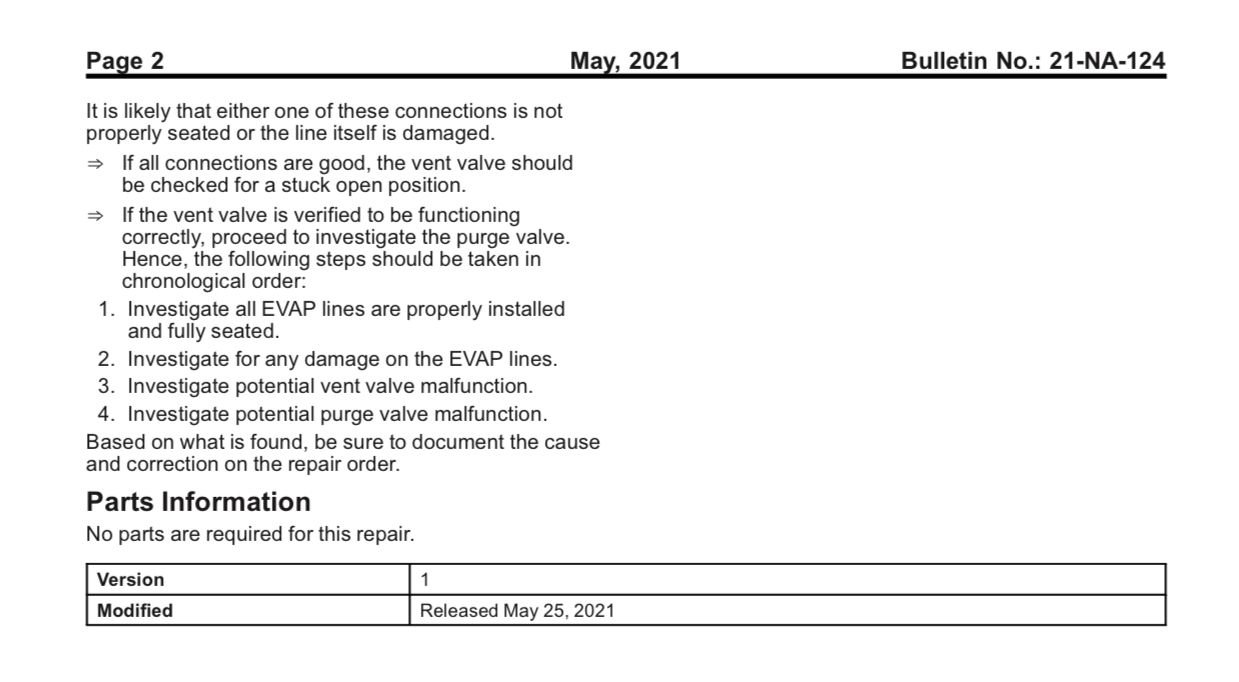

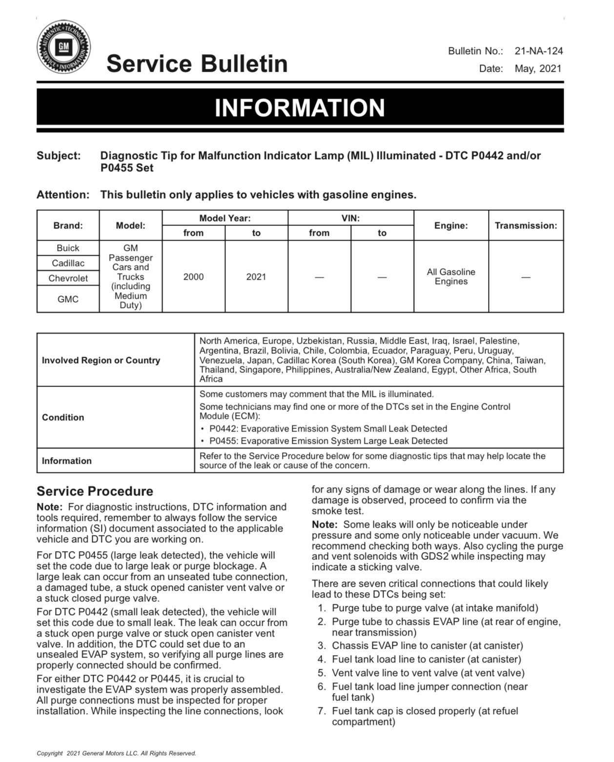

Originally Posted by jjtjustinjjt
P0455 is going to be the end of me. After changing the purge valve, I didn't get this code or the gas cap warning and was happy that I had finally fixed this 3 year problem. 282 miles later, bam!! Check gas cap and engine light! About to give up
This TSB discusses your not uncommon quandary. Nice long list of stuff to check.
Old Jan 2, 2025 | 09:34 PM
  #22682
jjtjustinjjt's Avatar
Joined: 07-20-2021
Posts: 42
From: Somewhere
Thanks pulp. Don't have time or patience to check all this. May just buck up and pay chevy to diagnose it. Then I'll fix it if it's easy.
Old Jan 3, 2025 | 07:44 AM
  #22683
PulpFriction's Avatar
Joined: 12-05-2014
Posts: 3,349
From: Northern Ohio
More likely they’ll return it with a 4-figure bill and the code will be back in a couple hundred miles.
