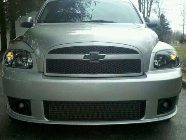

I drove mine to Maumee Ohio and had lunch with some great friends from here today, took my Mom HHR shopping in it yesterday,lol. Oh and last but not least, a pic of the new depos that I installed friday night.

Looks Great Dustin! Did you do the install Solo?

Yes, took my sweet time doing it, took about 3 hours to install everything I did to it(HID's for both headlights and fog lights, LED turn signals, LED front and rear side marker lights, and LED license plate lights).

They looked great in person

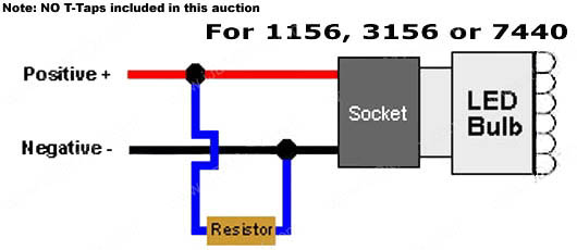

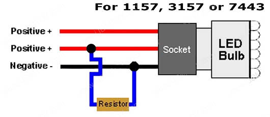

Man, I wish I could do LED turn signals. I just don't know how to do the resistors.

they are easy, they just splice in parralel with the wire going to the plug for the light.

lookie over here

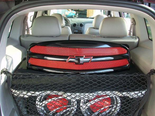

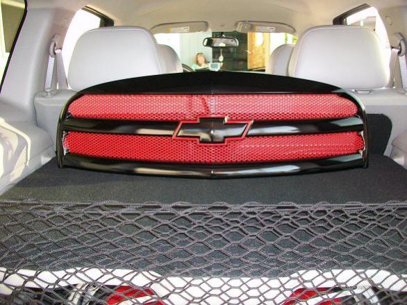

I finished up a three bar(not for my car) but turned out OK. The two color bowtie turned out to be b@*%H! Todd (uma)
