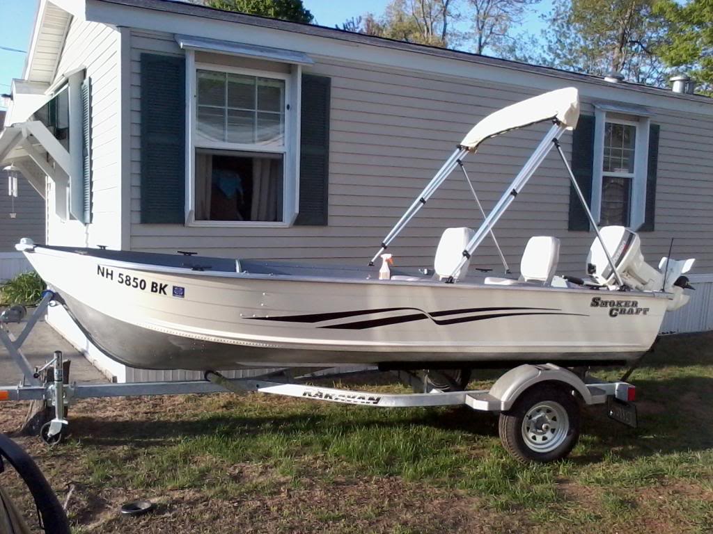

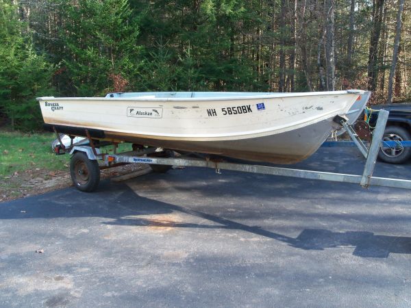

Anyways. I sold a bigger boat in order to build a smaller boat to keep in step with the 1000lb weight limit on HHRs With boat, trailer and motor, I am at 700lbs. The 2.4/auto HHR tows with no issues.
The boat is a just restored 1982 14' Smoker Craft Alaskan with a New Karavan trailer, and a 1994 15hp Johnson that I just restored too. I have 160 to 200 hours in it, and glad it is over. Now we can just enjoy the summer on it.
Before
After

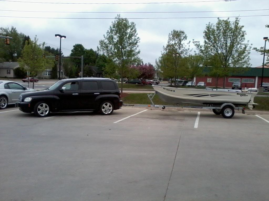

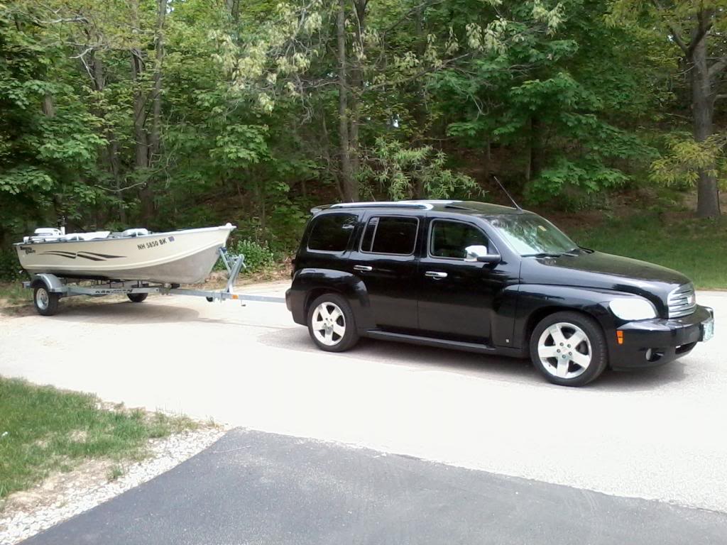

And of course. Being towed.
Before
After
Big improvement over your old boat.
See you put a Doel Finn on your 15..... Good move.
Whats with the extra long trailer tounge? Do you have shallow launch ramps?

P.S. I tow my boat with a 2011 2LT Black as well.
Curt Hitch and 5"riser ball mount with a 2" Curt Stainless Steel ball.

The two reasons for the trailer being so long is that I wanted a trailer wide enough to put the fenders on the outside of the boat to not only step on, but for stability reasons on the road. As far as the length, I do not want the HHR in the water at all. And the trailer with 56" between the fenders comes 21' long. So I had to take it this way to get it that wide.
