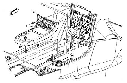

I have a 5 speed tranny and I am trying to figure out how to remove the center counsel. I want to take off both the plastic part around the emergency brake and the shifter itself. Does anyone know how to go about this?

Using a plastic prying tool remove the Front Floor Console Accessory Switch Mount Plate
Callout Component Name
1 Console Switch Plate Assembly
2 Retainer Clips (Qty: 2)

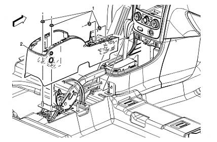

Remove the console trim plate.

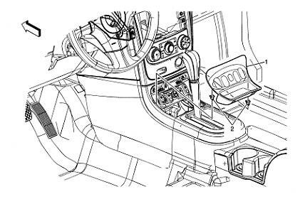

Apply the parking brake.
Place the shifter in the neutral position.
1 Front Floor Console Screws (Qty: 2)
2 Front Floor Console ( Console Trim Plate )
Tip
Disconnect the electrical connector.
3 Retainer Clips (Qty: 3)
Console Replacement
1 Rear Floor Console Assembly Nuts (Qty: 4)
2 Rear Floor Console Assembly
Old Oct 3, 2008 | 09:01 AM

Thanks ChevyMgr. That will save me a lot of time and aggravation of figuring out how to remove the counsel unit.
