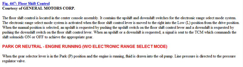

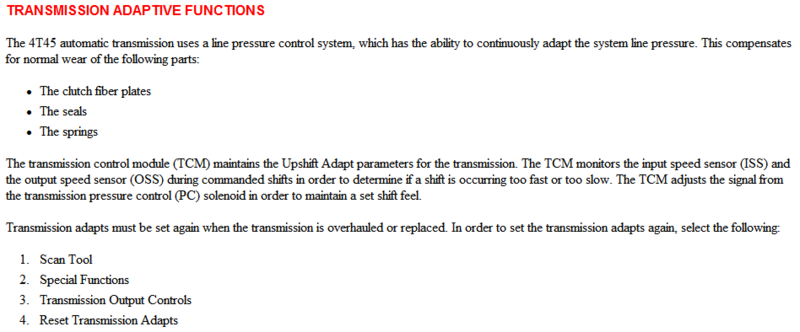

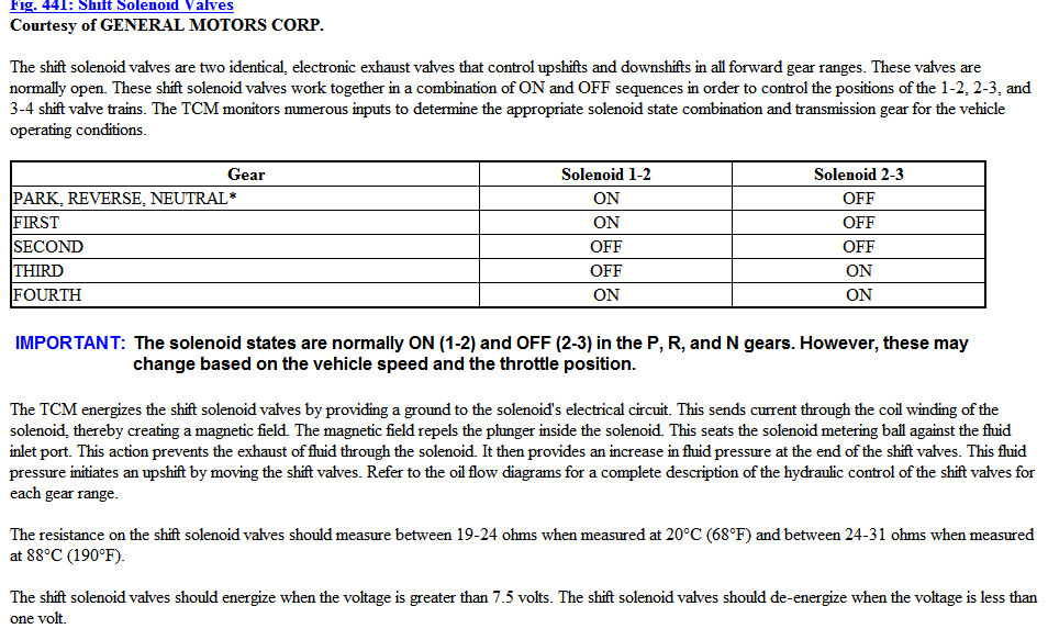

What about going from I to D?
I think you said you did replace the TCM?
Here is some reading material

ok here is what i did instead of building a full shift monitor i monitored the 2-3 gear solenoid signal with a meter. how ? ( like this ...i removed the radio as its not working anyway...used the ignition wire for it connected the hot to the hot to my meter..ran a wire from the solenoid ( yellow/black for the 2-3 solenoid ) drove it a few miles and guess what ? the tcm is sending the signal to shift because the meter voltage jumped to 15.5 vdc after around 35mph it shifted from 1st to 2nd then i watched the meter and bam 15.5 volts ... so its getting the upshift signal but its not shifting i assume its either a faulty (NEW) solenoid because you can apply power to it with engine off and hear it clicking...but that dont mean the cone in the valve is working properly...or a stuck or clogged valve in the valve body itself .... any thoughts before i tear it down again ???
