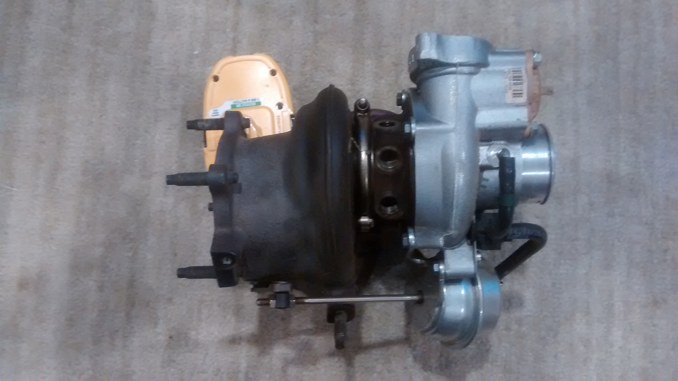

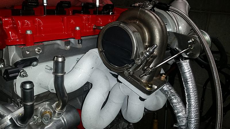

The Sky is not a transverse-mounted engine, and therefore has a different turbo. Here are pics of Powermizer's turbo that is on his LDK, going into his Sky.
And here's a pic of my spare HHR turbo
EDIT: upon further research, the turbo Powermizer is installing is not the factory config. But I still think the Sky is different. https://www.chevyhhr.net/forums/2-0l...e8/#post808819

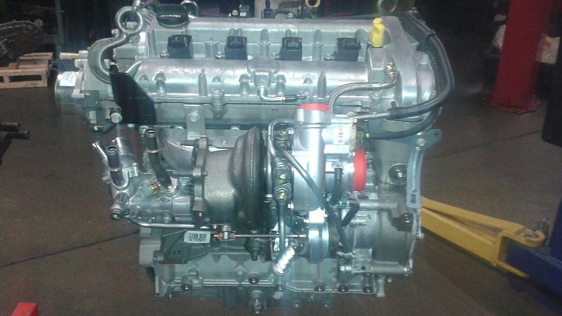

Upon FURTHER RESEARCH, lol. They may be the same. Here is another pic from Powermizer's thread, of a factory config(I think)?

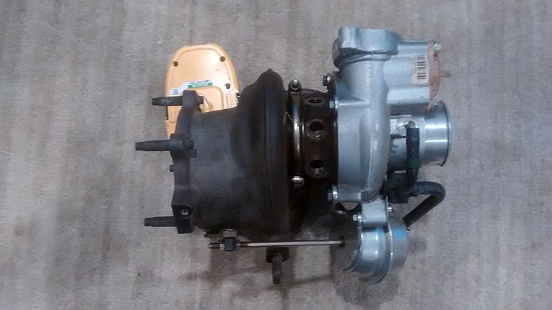

And here is another pic of my turbo, at a similar angle.
