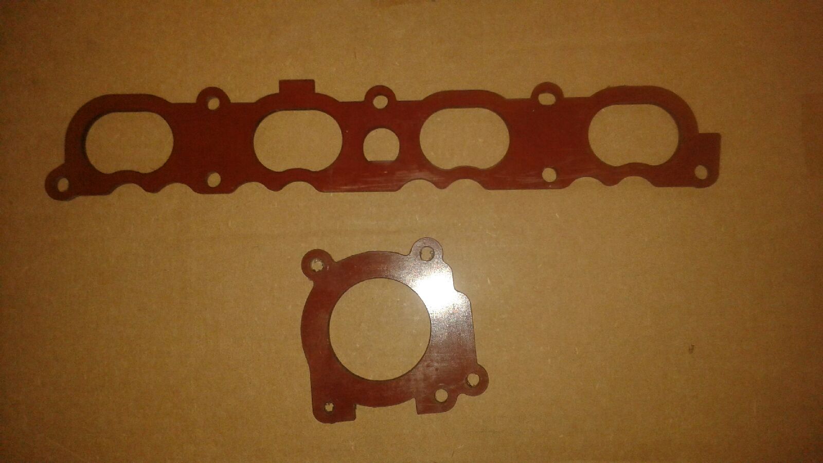

Thank you to mkriebs for the good buy on these phenolic spacers. I got tired of waiting for Werks to bring them back.

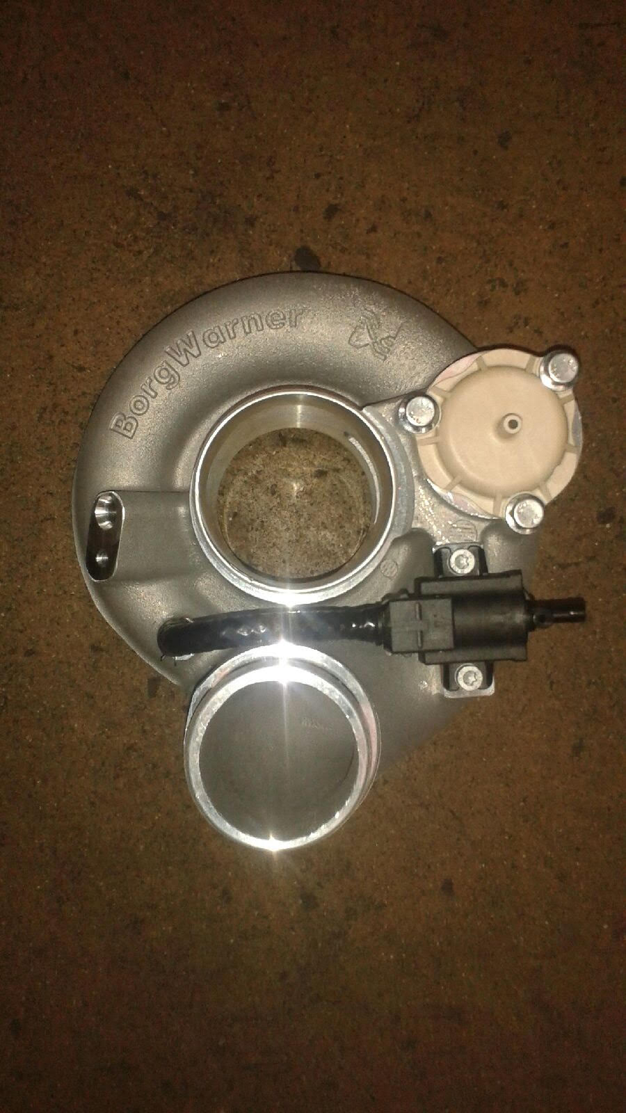

This housing from Borg Warner has taken me 5 months to get. Just got it today. they tell me it is the only one they have done. I don't know if I believe that, but I can say it will make my installation much cleaner having the outlet facing forward.

Nice. I welded the stock turbo elbow on. That allowed me to keep the stock IC tube location.

I looked for a stock turbo outlet, because I needed to keep my original one with the stock engine. Just decided to go this way when I saw it, nice and compact. More Picts coming soon!
