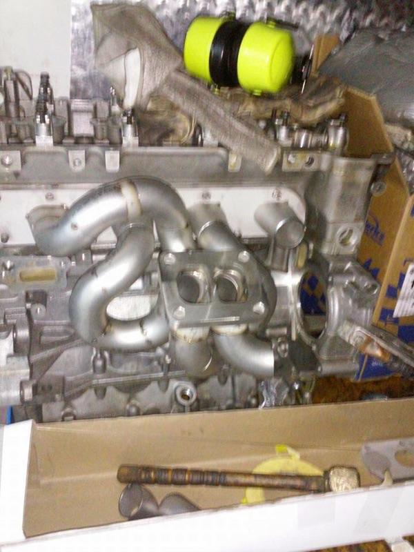

This is the beginning of the manifold build. For the ones who don't know, with a twin scroll manifold on a 4 cylinder engine, to make the turbo work the way it is supposed to 1 and 4 pipes have to go into one side of the turbo and 3 and 4 into the other. It's a pain to make everything fit, but the turbo spools up 200 to 300 rpm faster and just the over all drivability is better.

Turbo on just to give an idea of how it will look.

There's room for that between the head and the firewall?? It's to cool to hide back there!
Any thoughts on header insulation tape to keep the heat down?? Or a blanket in the turbo?
