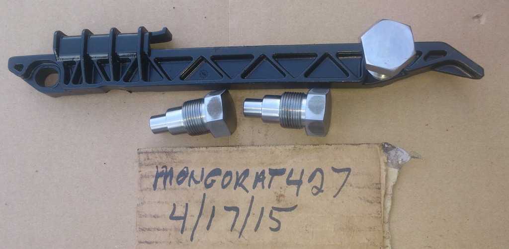

I would be interested in one of those as well. I was considering the ARP fix but that looks like a better fix.
Powermizer, do the balance shaft bushings you had made have to be pounded in like the other I have seen? I'm not to keen about pounding in a bushing that can't be removed, was considering making a bushing that is removable or just putting the balance shafts back in since they won't do anything anyway.

The back ones are from OTTP. They are threaded in center. Front ones are just like a bearing. I wasn't worried about having to get the front ones out.

mongorat427 on cobaltss has them. they are a hex head. sayes he has plenty of them. I have his number if you want to pm me.
