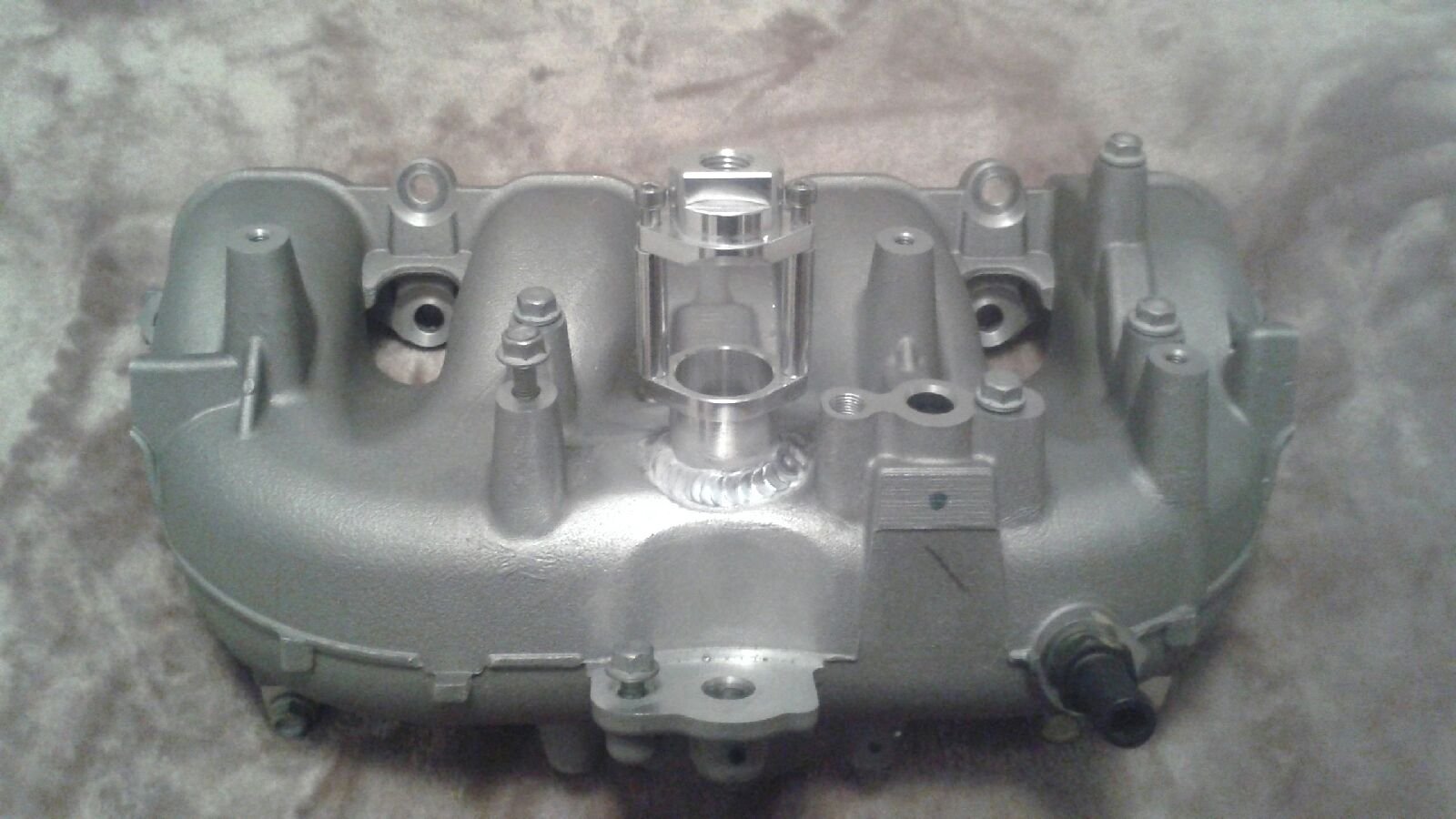

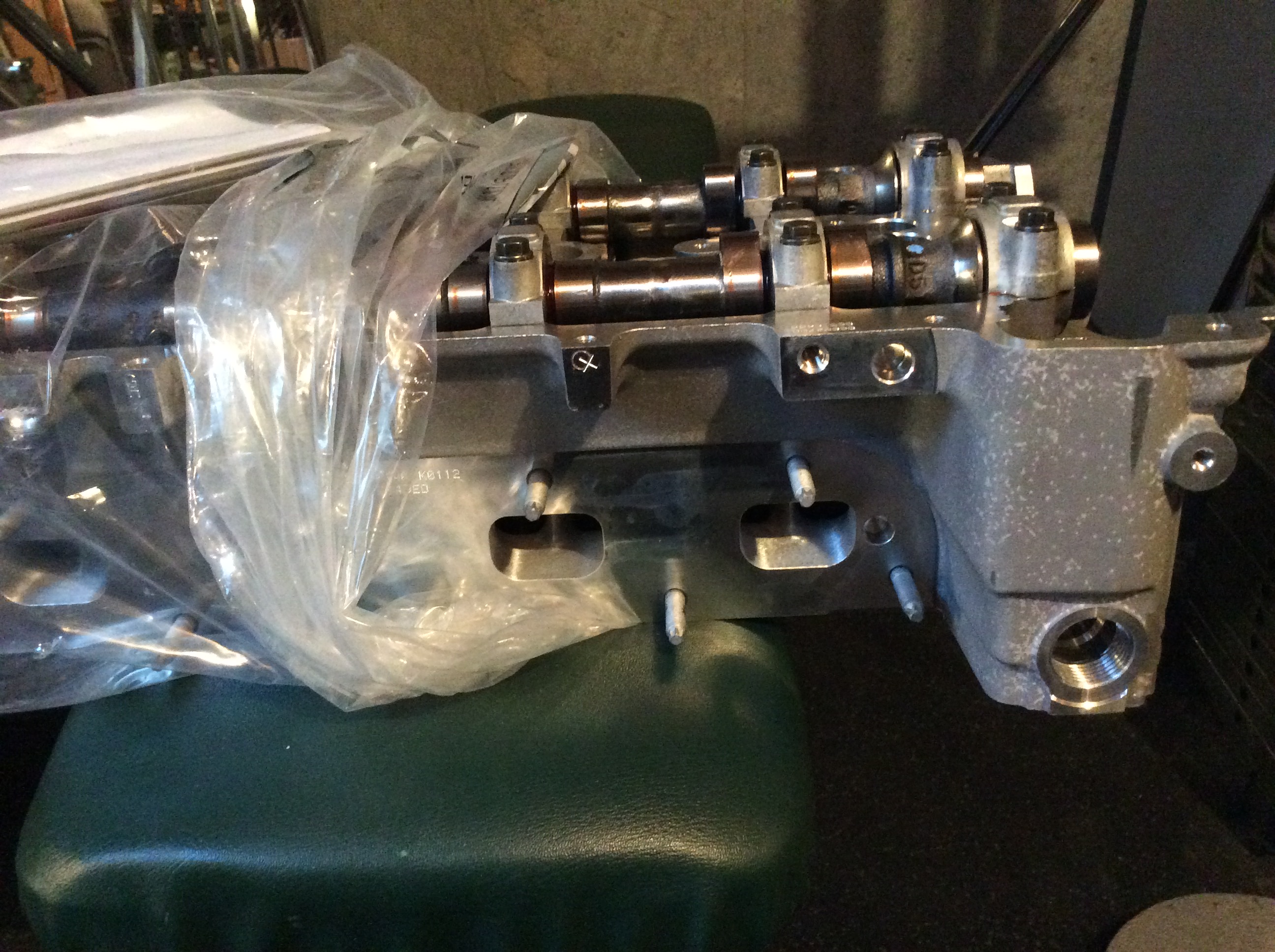

I have a fifth injector and bung is welded. I also have a ZZP ported head with stage two cams. I have to change out the springs. I just feel better having the dual springs.
LNF-ZZP ported stage 2 cams

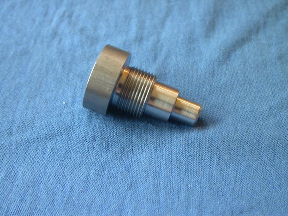

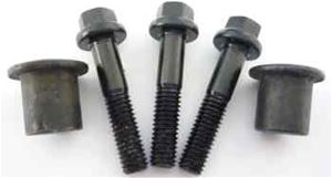

I have a question about the chain guid bolt at the top where you pull the plug in the head to take bolt out. Are we better just going with the ARP bolt, or use the repair bolt that is made to fix the broken bolt syndrome? The later seems like it would be stronger. What's your guy's thoughts on this?
Old May 3, 2016 | 09:31 PM
  #28
Posts: 40,083
I would !
Old May 3, 2016 | 09:34 PM
  #29
Powermizer's Avatar
Joined: 05-01-2016
Posts: 140
From: Utah
This
Or this?
Old May 3, 2016 | 09:43 PM
  #30
Posts: 40,083
This, did you get the part number, or order one from Mike Brandt
