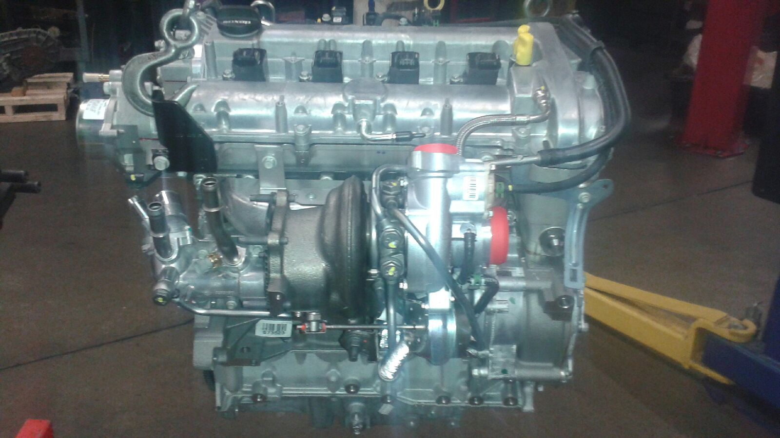

I was asked to show my build. I have built many supercharged and turbo engines, but this is my first 4 cylinder.
What I have is a 08 Saturn Sky Redline. This is the only forum that I have showed what I am doing. Hopefully some will enjoy.
This is the complete engine I bought.

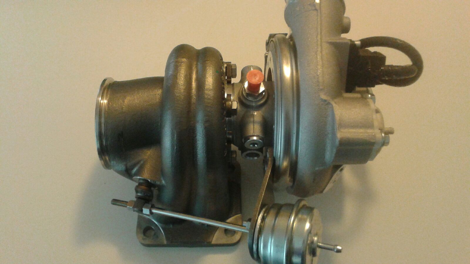

The first thing I bought was a turbo so I wouldn't fall off track! Lol
This is a EFR 7163 twin scroll turbo.

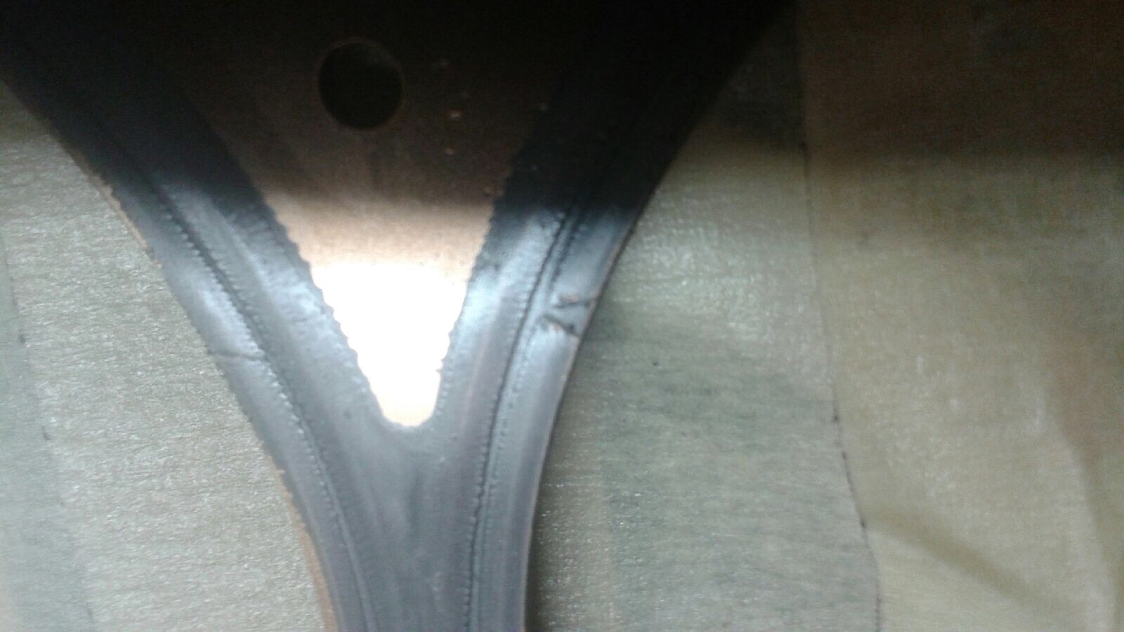

I started to pull my new engine down and this was my nice new surprise!
Head gasket

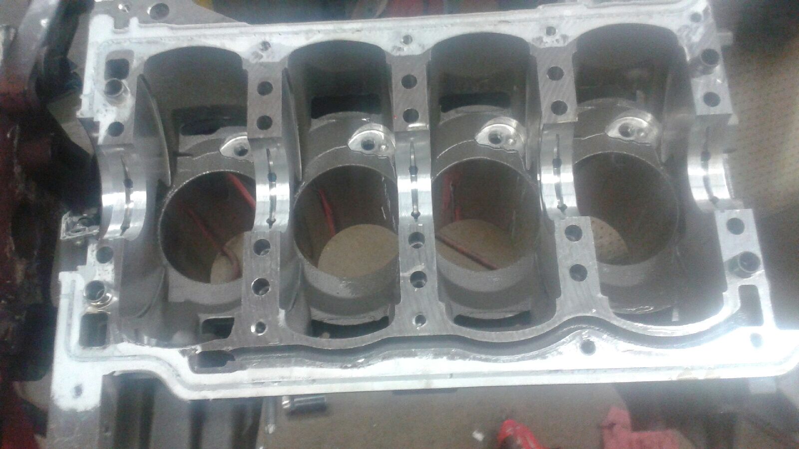

The engine striped down completely.

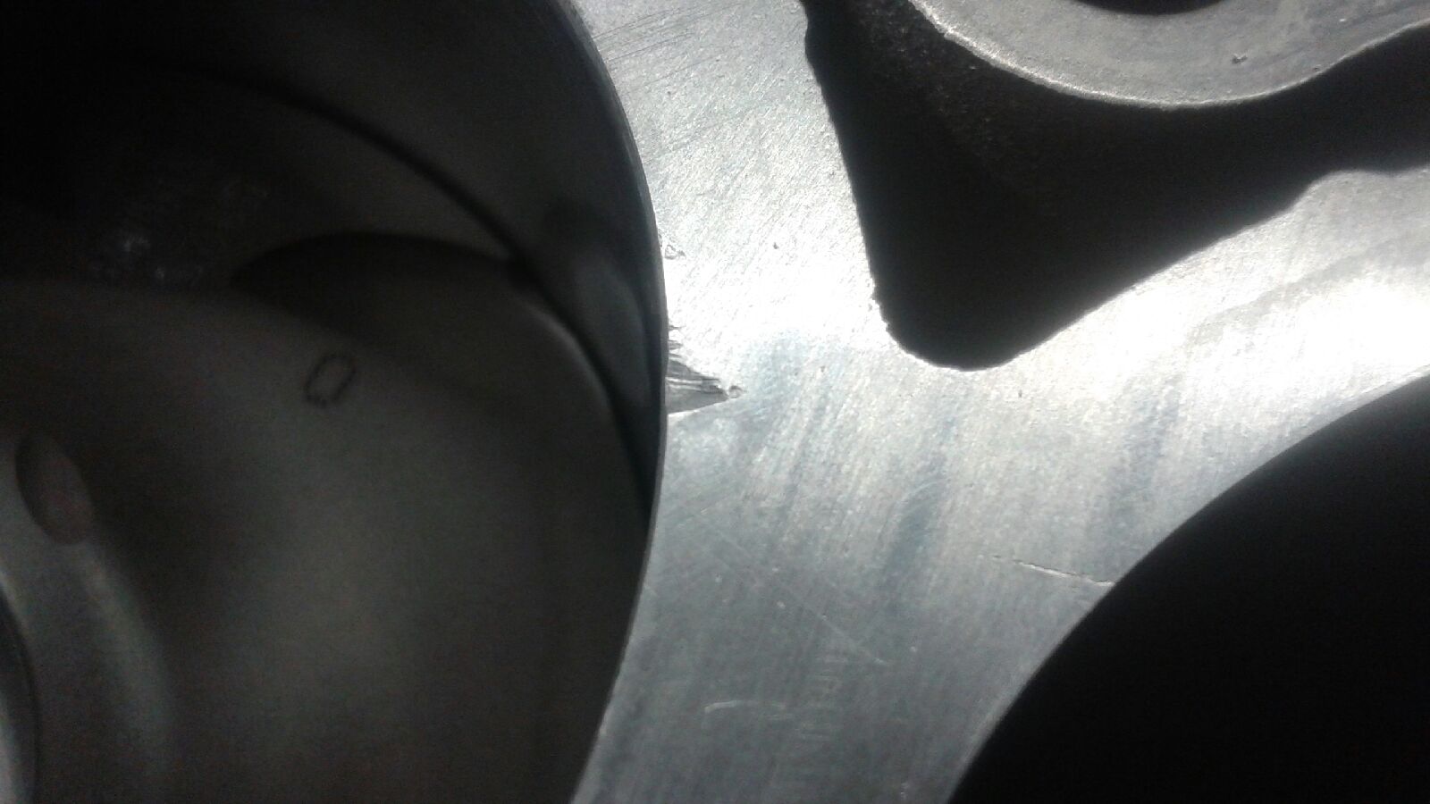

So, the engine was used? Is that why you tore it down? What happened with that gouge?

My car has 14,000 miles on it with the LNF. I just decided I need more power after tuning all I can get out of a mostly stock LNF. I bought a brand new LDK crate motor, turbo and all, too start my project. I wanted the better block. so I will have a complete engine to take out. I like having a spare engine, If you know what I mean? lol
If you look at the deck it looks like they slid it over a dirty bench. Made me mad, but all will be well when I get it decked. I have to say the picture makes it look worse than it is. I can say it wouldn't have survived if I had just installed it in my car. That nick goes right into the fire ring on the gasket.
Old May 2, 2016 | 11:58 AM
Posts: 40,083
A few thou off the deck , smooth as a babies bottom, and a bit more compression!

yep, going to the machine shop this week.
