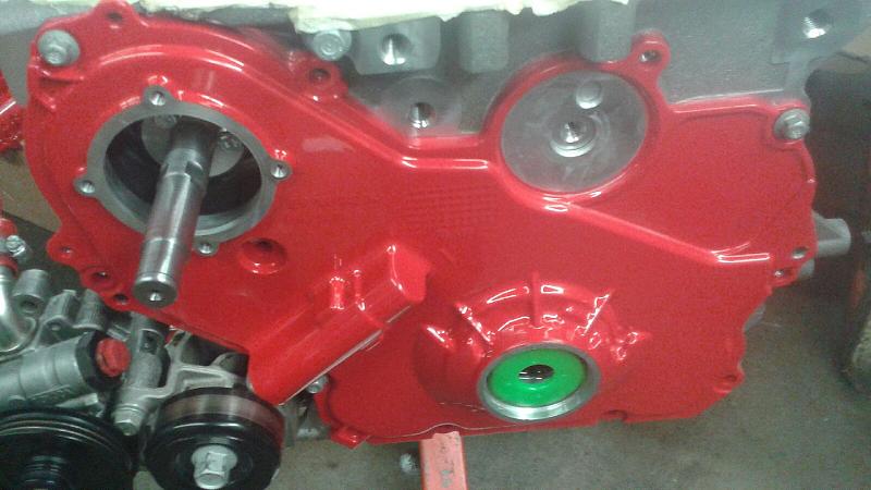

Shaft that I had machined for water pump.

Cover installed and shaft protruding.

Bearing hub machined and installed for support.

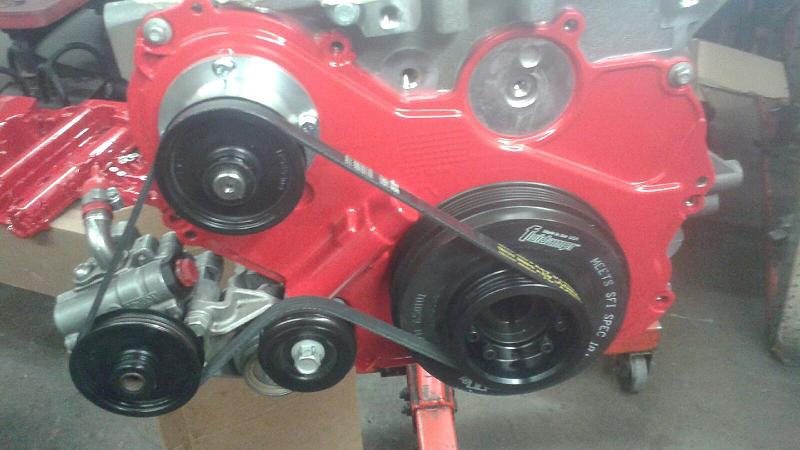

Pulley and belt installed to show my idea of a belt driven water pump. The stress on the water pump will be relived substantially. Plus the water pump can be changed a lot easier. I wanted to use a electric water pump but could not find the room I needed to plumb it.

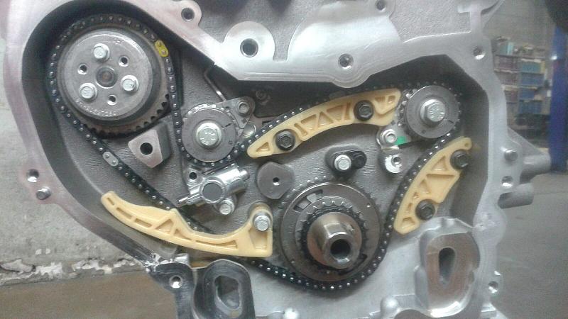

Here is what is removed for those who may not know. Yes I know the the chain tensioner guide is off. I just put it together to show all that the little chain has to do.
